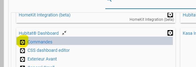

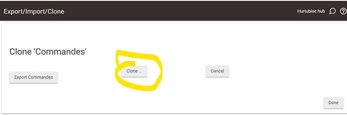

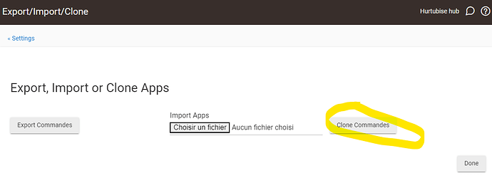

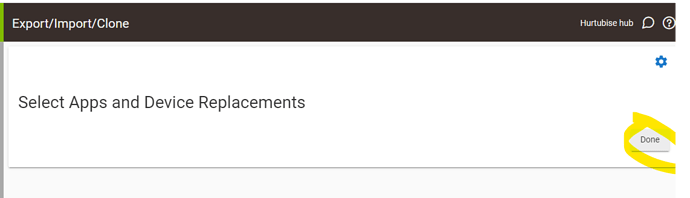

Hum it might be a code 22 ( inches behind the keyboard). Maybe I dont get it right. See below the sequence of steps I am doing.
1
2

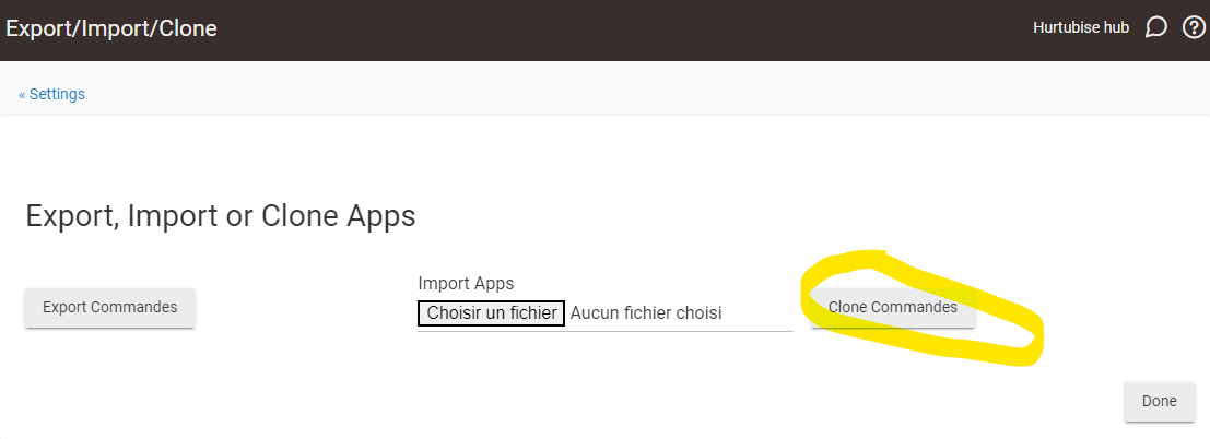

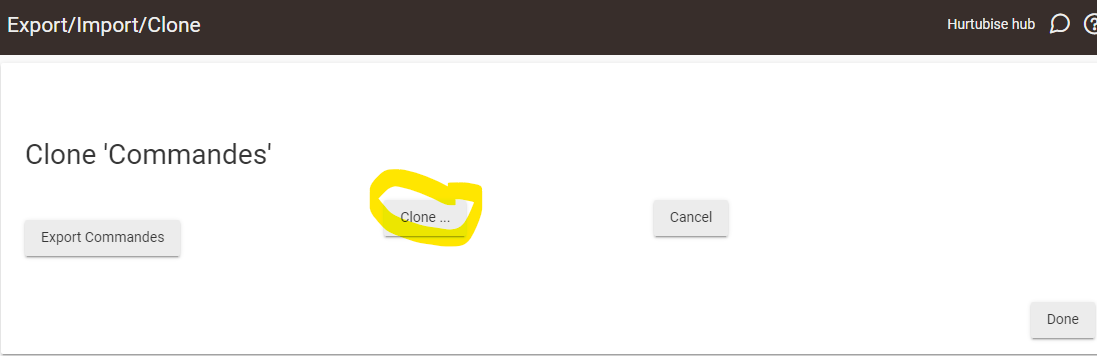

And then it loops on the last 2... must be something I dont get if it works for you

Jeff, thanks for your reply. You made me think of a way to isolate the problem. To your question: "Do you have any valid devices allowed on that dashboard to begin with ?" made me think of trying to create a dashboard with only one simple outlet in it.
Then I went and clone it.... it worked no problem....
To your initial questions, all the dashboard I have contains valid devices in it, but .... and I'll have to investigate .... most of my device have UTF8 characters in their descriptions ( French speaking... cannot help it)...
I wonder if that has an effect.... will do some more test and post my findings here later on...
Thanks for the Eureka moment :slight_smile:
@support_team this sounds like a bug in the dashboard cloning. Not sure who handles that. See above screenshots of the device selection page which does not show any devices.
OK I found out how to reproduce it. Not UTF-8 related but rather what is present in the dashboard ( or in fact what is not present).

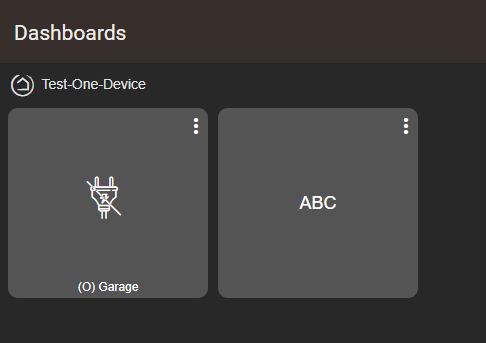

Clone that works... Only one device ( outlet )
Clone that does not work. Add a Text Tile ( or a Link tile) then we end up in that loop situation.

Yes, definitely seems to be connected to how many devices are exposed in the dashboard definition.
Not how many devices, but rather what type of tiles.... Device tiles vs TEXT/LINK tiles

I tried with multiple Devices, Link and Text tiles. Conclusion: Text tile is the culprit
