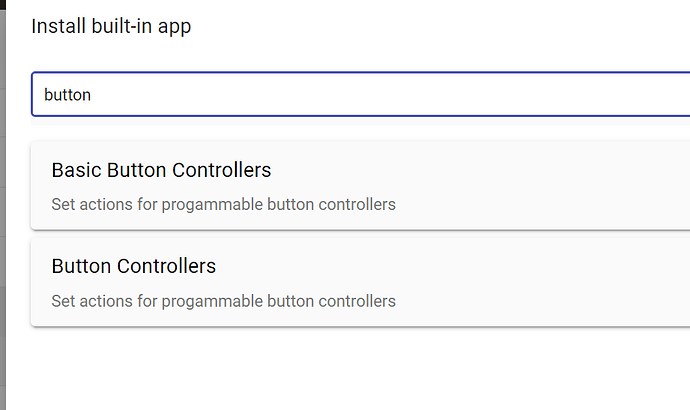

You don't need that many buttons. You can create multiple button numbers on a single device. And the Button Controller app can keep all the "rules" grouped together.
so you mean like this.
3 physical buttons. Create 1 virtual button, That one virtual button will have 3 button states that i can use. Those 3 button states can action the 3 physical buttons.
I'm not sure what you mean with "physical" or "states." My suggestion is to create one virtual button device, set the number of buttons to whatever you need, then use Button Controller to create whatever automations you want in response to your desired combination (e.g., button 1 pushed, button 2 held, etc.).

can get granular with what the buttons do. This is nice! didn't know about button controller.
So far i achieved similar results with virtual buttons and rule machine. Button Controller looks easier to work with.
You will likely find this out as you start to use it, but from your last screenshot, you might notice that under the "Button" column there is the number 1, if you choose to expand your BC rule to cover multiple buttons, e.g. 1, 2, 3, etc, then you will see these represented here with rows for each.
yea i created one virtual button with 21 buttons. And in Button Controller will make the rules for all of them. Then make it appear in dashboard as i want.
