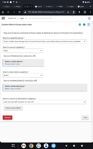

I have a water shutoff valve that shows as a switch device. I'm trying to use a custom mirror to have a virtual valve (so the dashboard looks right) set the state of the switch. Toggling the valve doesn't change the switch at all. Any suggestions?
It says your source attribute for the valve is using the values on and off. The virtual valve uses open and closed.

I think I understand what's going on the source driver has both switch and valve correct?
If so custom mirror perhaps is favoring switch over valve when selecting the source mappings, or some other confusion.
If that's the case I can run some tests,
Screenshot 2025-02-06 at 6.39.15 AM
The actual result seems correct.

Yup, actually a bug in the mapping mappings data structure, will be fixed in the upcoming 2.4.1 release
