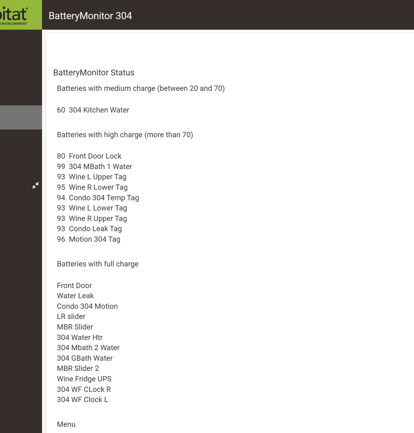

I keep this on my dash among other things.
Basement Sensor is a coin cell so once it shows on the Inactive list for more than a few hours I will replace it.

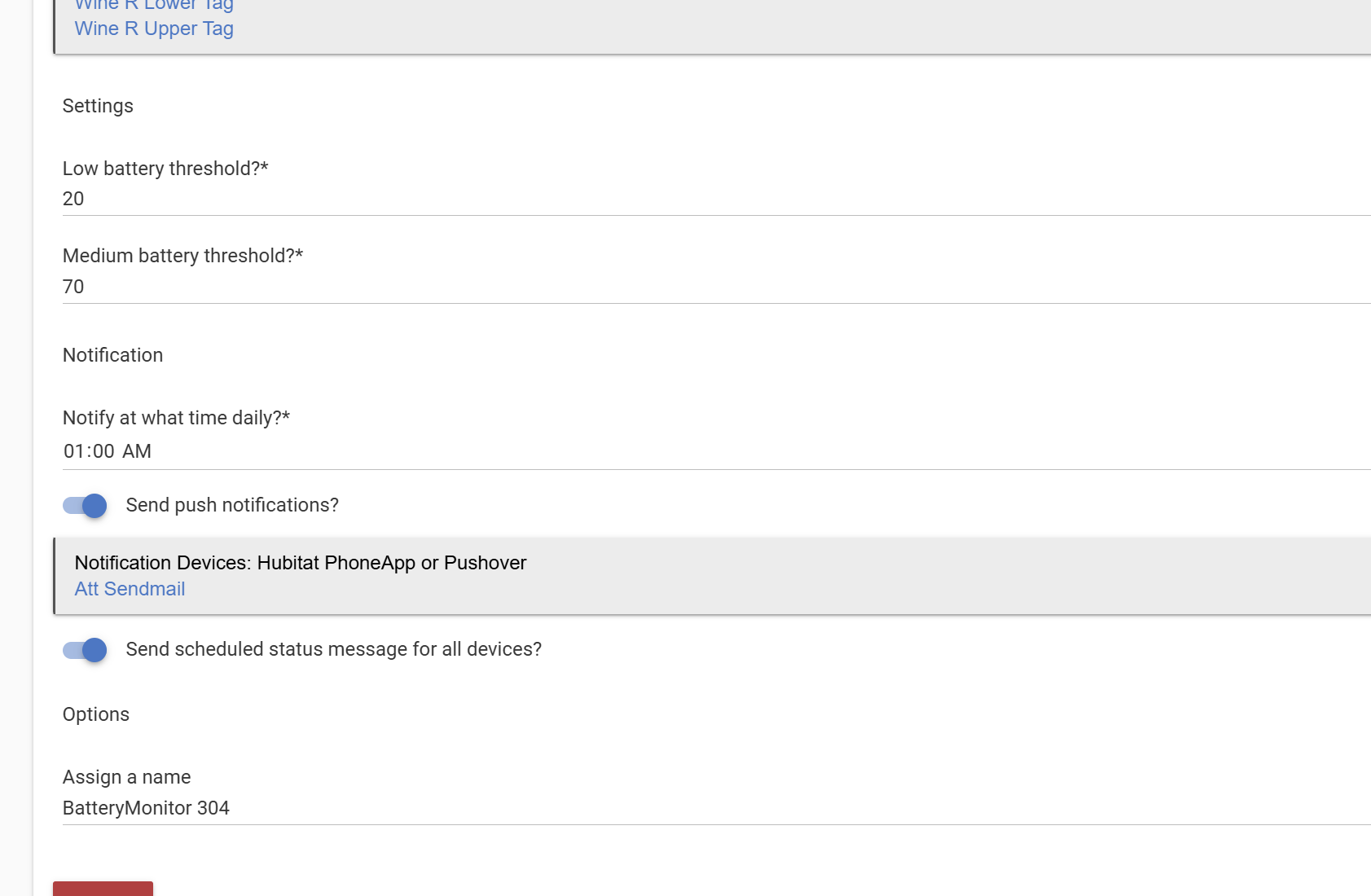

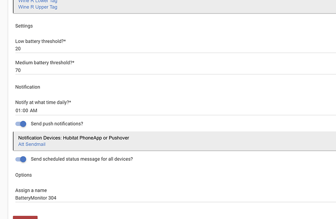

Just pushed update 1.3 to allow different thresholds for different groups of devices. As for the other suggestion i am working on that now but may take a min.
1.4 added some examples in the code for the custom configuration items

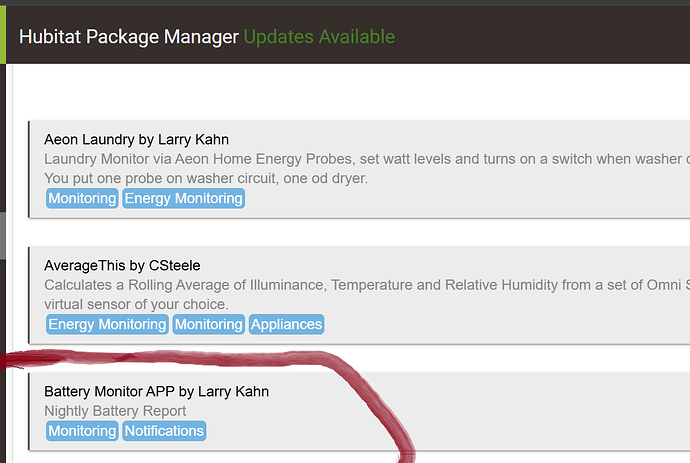

Personally, I use device activity check and monitor battery levels but usually just wait until device activity check tells me that a device has missed its check-in to replace the battery.
Interesting, when I searched, I did not find any others. Thanks for your solution. I still plan to work on this one but it's good to see that other solutions are available.
