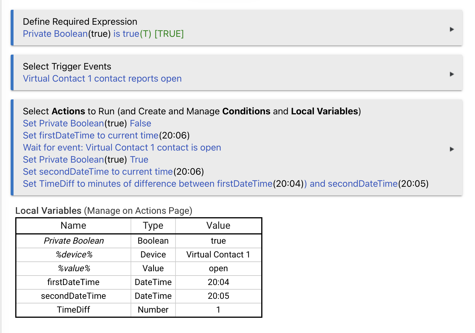

Here’s a sample RM rule that will provide you with what you’re looking for:
The Ā« Define Required Expression Ā» is using the rule’s Private Boolean to ensure that the rule only triggers every other time the door opens.
This rule will give you the difference between the first and second time the door opens in minutes. Another option would be to calculate the difference in time between every times the door opens.
Does this help?
Thank you! Yes it definitely worked.
I just added an additional action item of sending a notification on my phone of that "TimeDiff" value. Thanks again.
