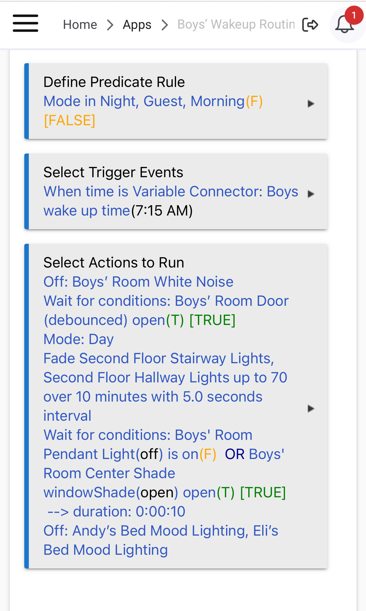

For example, I have a rule machine rule that does several things when my kids wake up. Here’s a screenshot of the rule:
For the purposes of this discussion, ignore the actions but notice that the trigger is using a variable device.

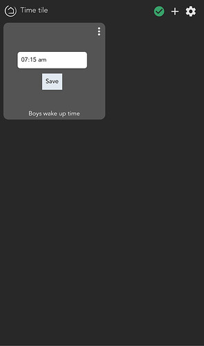

Now here’s a dashboard (legacy dashboard, not a newer Easy Dash) with a tile that allows me to change the trigger time:
Not quite as complex as what you’re describing, but it might get you closer to what you’re trying to do.

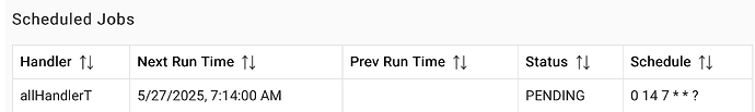

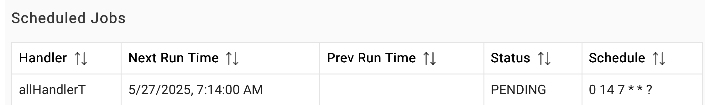

Scheduled jobs (for the rule I posted above) look good to me:
This is after I just changed the tile from 7:15am to 7:14am.

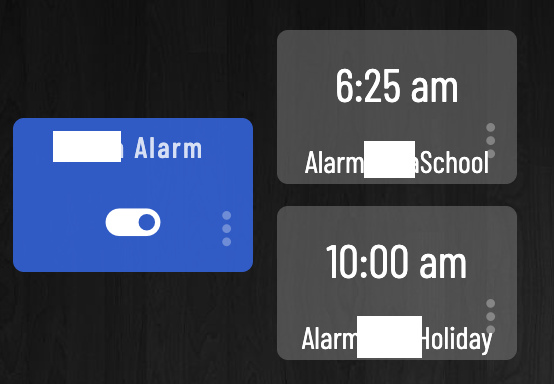

Are you looking for an alarm clock?
Screenshot 2025-05-26 at 1.29.33 PM
  1. a variable to set the time
  2. a switch to turn the alarm on
  3. a rule to do something when the alarm triggers.
You could make a timer too. Make the variable a number. Set the variable for x (minutes). Turn it on. The rule looks for change to the virtual switch, and sets an off command for "now ofset x minutes". Then the rule in #3 takes over when that virtual switch turns off.
