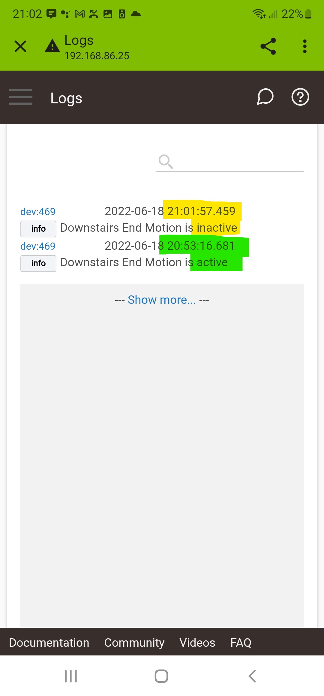

Thanks for all the replies. The logs won't go back that far on the other issues, but I do have the latest one with a picture of the log. Maybe this one could be figured out. It has stayed on several times without turning off. There are two triggers...motion active and stays that way for three minutes and motion inactive and stays that way for three minutes. Neither work. They just wait...forever. The smart plug works and can be turned off and on through the device page. The motion is also controlling the lighting in a separate rule which is working perfectly as well. Here are some log shots. The fan is still running as I type this which is about 18 minutes of the motion being inactive.
