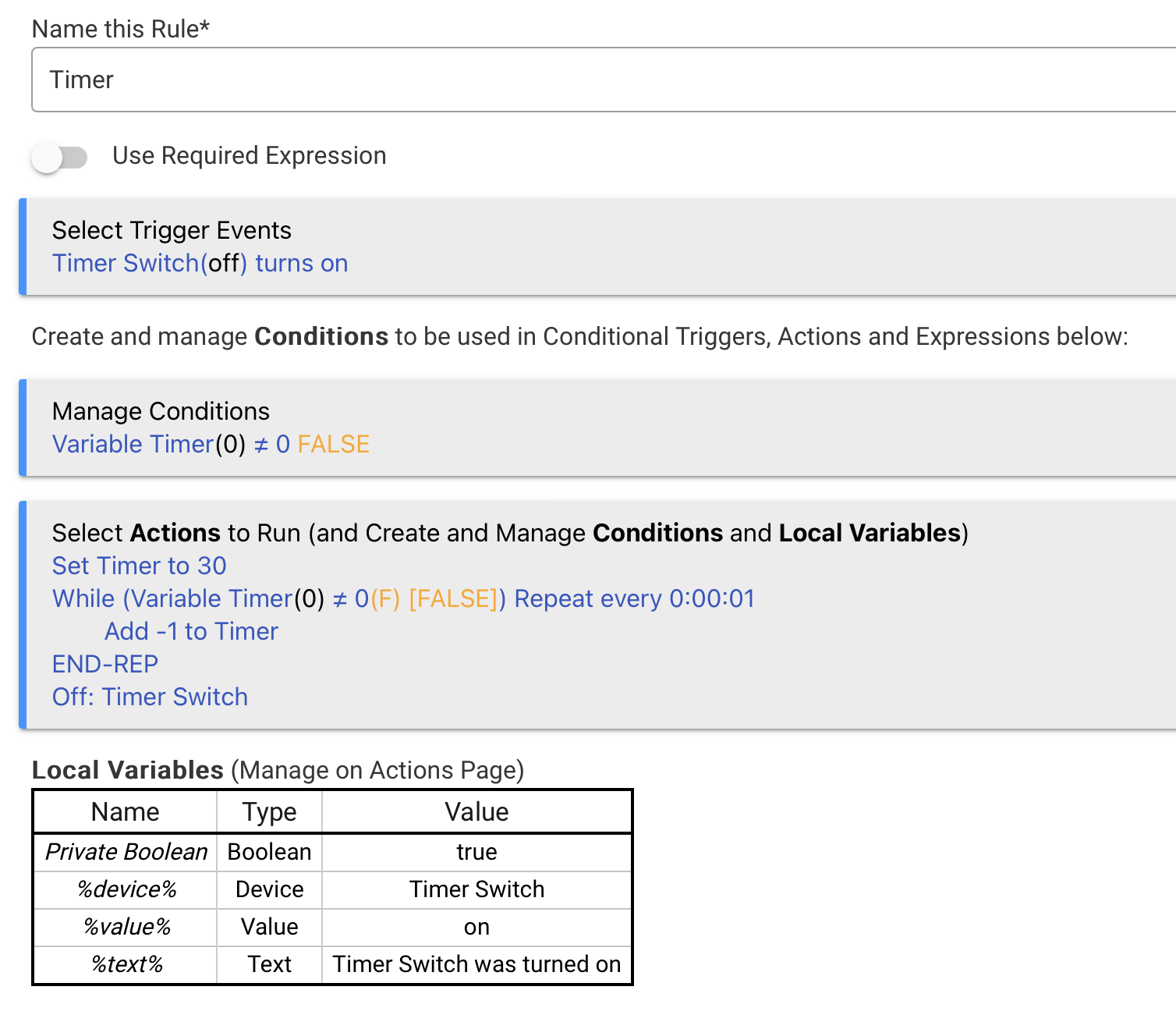

I know very little, but I doodled around with this just now while eating breakfast.
I created a hub variable, timer, which you can choose to display in a dashboard tile. The interval I set was every second, so it counts down from 30, but you can change that.
