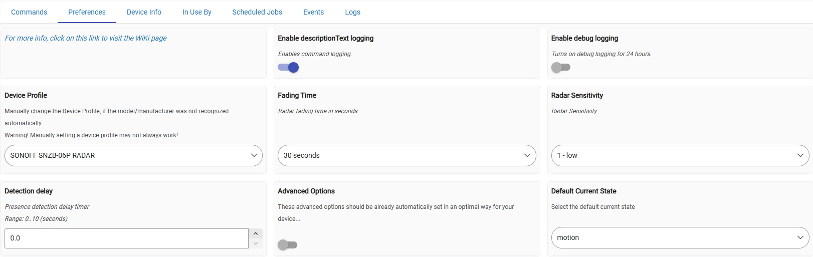

I just noticed this. I set Radar Sensitivity to 1 low. When I hit reset it goes back to 2 med.
Did you set it in the "Commands" section or "Preferences" section of the device page?
Setting it in the Preferences section is the only way to set a persistent setting. Setting it in Commands is just a one-time command -- it will reset back to the Preferences setting upon refresh.
I thought I did that, evendently I didn't.

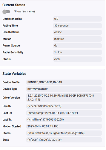

Hey KKossev, again thank you for all you do to support the community! I have a Sonoff SNZB-06P i just tried to install and test. I have your current 3.5.1 driver in use, configured with the Sonoff SNZB-06P device profile selected. I loaded the defaults and the device is responding to pings just fine. NMW the motion state never changes from inactive. Any advice would be appreciated! Joe
It appears to be reporting lumens properly, fyi jj
Correction, lumens is reporting 'null', j
Did you try pairing the device again close to your hub (without deleting it)?
If it still don’t work after re-pairing, enable the Debug logging, then remove the USB power for 30 seconds and power it back again. Anything in the live logs after the power on?
(This device does not report lumens, but only a binary ‘dark’/‘light’ state)
Bummer on the dark light state, FYI i have a TS0225_LINPTECH_RADAR and i ordered the Sonoff to replace it. It worked on both lumens and your driver, but just false reported motion all the time NMW how I adjusted the config.. is there a MM radar you like that does both? Thank you and I will go pull the data you asked for. jj
