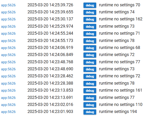

Decided to test but without having a blank hub doing nothing else id say the same.
void mastSwitchState(evt){
if (evt.value == 'on'){
def date1 = new Date()
/// loop
for (i in 1..10000) {
for (com.hubitat.app.DeviceWrapper dev in settings.mastSwitch){
def id = dev.deviceId //some simple work
// loop end
def date2 = new Date()
log.debug "runtime settings ${date2.getTime() - date1.getTime()}"
date1 = new Date()
/// loop
for (com.hubitat.app.DeviceWrapper dev in mastSwitch){
// loop end
date2 = new Date()
log.debug "runtime no settings ${date2.getTime() - date1.getTime()}"
Don't know how scientific my test was.
well that's probably how I would have tested it, but as you can see there's no repeatable difference, probably the outliers being due to the hub allocating CPU to something else at that time

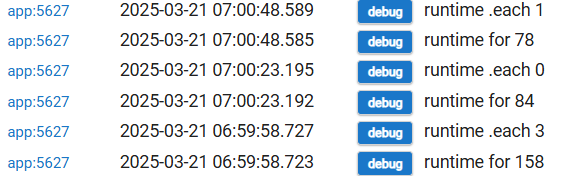

i tested your .each instead for for, and a lot faster
however when i rolled it out it didn't work with the return command it just carried on running the rest of the code.
