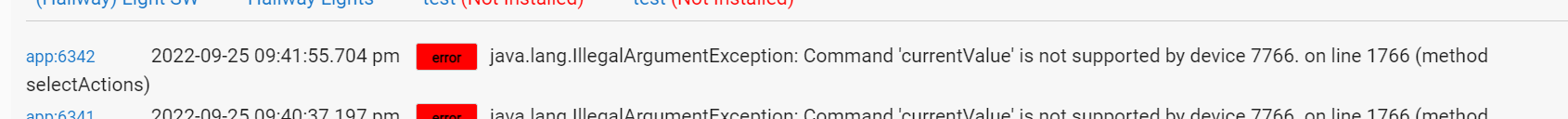

then when i import it and try to paste this is what you get.
What is device 7766?
Try turning off Display Current Values.
RL activation device
Is (Hallway) Light colorMode RGB a custom attribute?
same with it on or off.
maybe let me check, its a system device.
yes, you have to go to custom attribute to use it as a condition.
I can reproduce this one. Will figure out a fix. Has to do with custom attribute and paste.
Found it, fix in next release.
