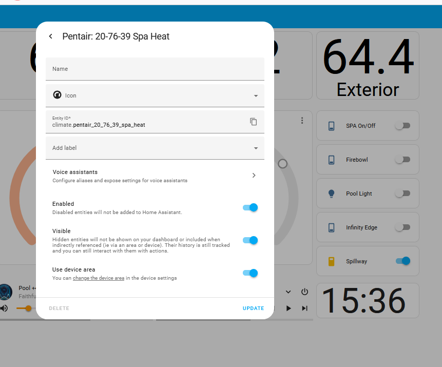

OK so I gave up and decided to create a new HA instance in a VM on an always on PC. Was able to bring it all into HE and can control just fine. However the control of the SPA through the HE dashboard is very limited. I can show it a Bulb and it works but is there anyone that can suggest a better looking dashbord tile?

Well I gave up on some functions of HE. It was kind of easy with HA. Now I am running both HA and HE in the same house. See my dashboard

How did you set up the SPA Heat Icon on your dashboard?
As mentionned I endend up using HA for that. I used thermostat widget in HA
Tried to use the thermostat widget in HA for it. Said there was not any devices for it. :frowning:

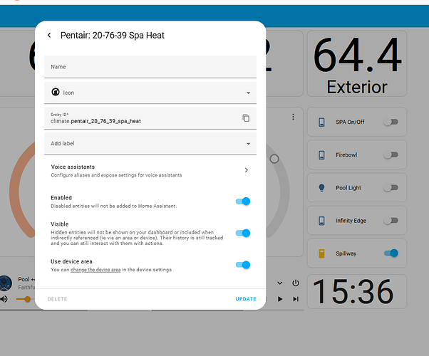

You need to connect the Pentair SPA to HA. Then the divice climate.pentair_20_76_39_spa_heat should appears see screen shot
You can add the integration with this link
I used the Intellicenter HA integration.
I would assume it would have integrated much like the screen logic. Would there be any harm in using both Integrations IF that one worked with Intellicenter ?
