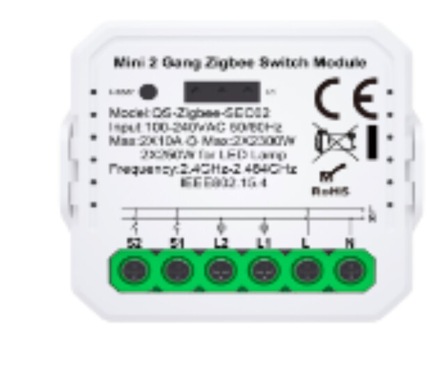

Device: Zigbee on/off light micro module
Driver: Zemismart ZigBee Wall Switch Multi-Gang
The driver shows that the switch can be setup as switch type: a) Toggle; b) Momentary ; c) State
Objective:
Having a momentary switch connected to the module. (there are no lights in relays S1/S2, the module will only be used to control trigger actions).
L1= "Press" the momentary switch = Turn on TV
L1 = "Press and hold for 4 seconds" the momentary switch = Turn off TV.
So the same switch depending on how is pressed (pressed or press+hold), will have a different action.
Can someone with RM knowledge advise on how to get that done? (if is even possible having this kind of switch). Thought using the switch type "state"RM with "stays 4 seconds" for the press and hold.
Any ideas? Thanks!
