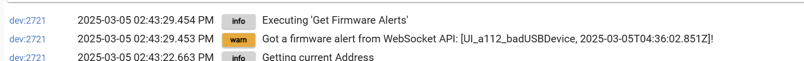

  • version 2.24 noticed alerts also come in in bulk (in realtime) from the websocket api when one occurs. Or it appears whenever a full wake command
  • is issued the websocket api also sends all the alerts. (I assume this is in case alerts were missing while car was asleep.
  • For this reason added code to just get the last alert from the set of them in realtime and put in 2 attrs lastFirmwareAlert and lastFirmwareAlertTime.

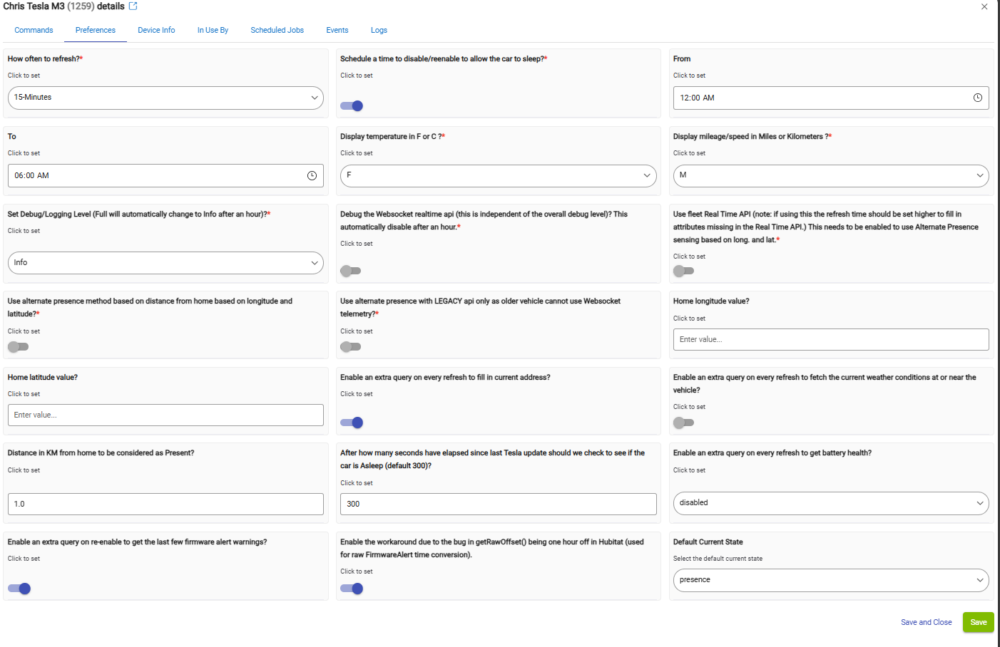

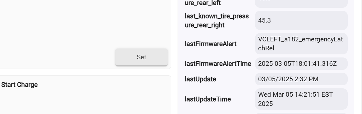

new option added as a workaround in a hubitat bug in the getRawOffset in the location.timezone record. it is one hour off for DST.
before fix
after fix

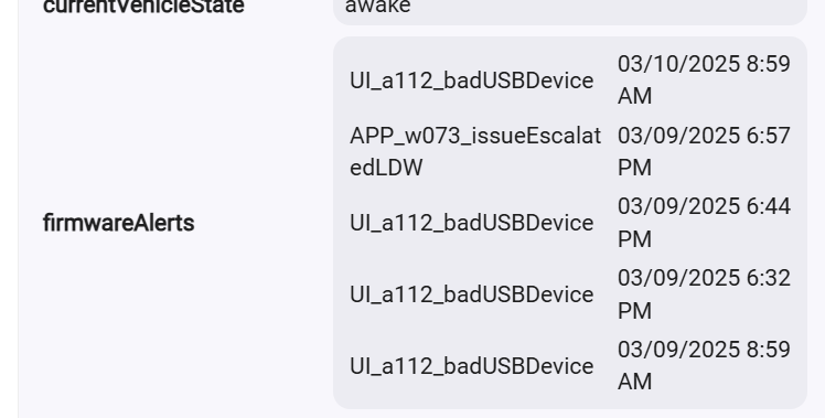

Can you please provide some clarity as to when to use the "workaround" parameter as when I have it off the Firmware Alerts match what I'm seeing in Tessie. If I turn it on than it is 1 hour ahead of what Tessie is reporting. Also, is the reason I'm not seeing the new "lastFirmwareAlert" attributes showing up is because I have to wait for a new alert to come in?
What Tessie is reporting
What Hubitat driver reports if "Enable Workaround due to bug" is set to off
What it reports if set to on
yes you need to wait for a new alert before you will see last one.. it is a totally differ api that returns it.
as for the workaround it is for a bug in daylight saving time offset in hubitat.. are you in an area that does not have dst... if so that is why you wouldnt use it.
Thanks for the confirmation on why the new attribute is not showing up. As for the Timestamp, I'm in California, where we observe DST. I'm guessing that since my last alert was 3/5/25, which is before we switched to DST this past Sunday, that's why time stamps are matching with the Bug parameter off. It sounds like when I get a new alert, I will need to flip that Bug parameter to on to get the time stamps to match. Thanks again for continuing to make this Tesla Hubitat driver better and better.
i am not sure that is it.. maybe the bug is not affecting you.. will see when you get a new alert.. it seems to be hit or miss. and may be dependent on what time zone you are in.

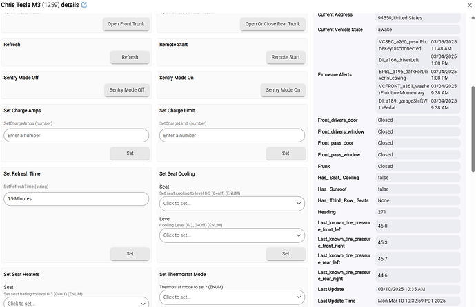

For testing and feedback, is there a way to get more than the last 5 alerts? I had to turn on the hack, and then click the get firmware alerts button and the times corrected themselves by the one hour jump forward. However, all of the alerts are just after the time change. I do see a few more alerts in Tessie prior to the time change and am wondering if those times are correct or not. Or whether that would help figure anything out or not.
Edit: I turned on debug logging in the vehicle and the app, and OMG, I got all the alerts since October! (using the assumption that the timestamp is the unix epoch. Need to find a way to just process the last 10 messages or so.

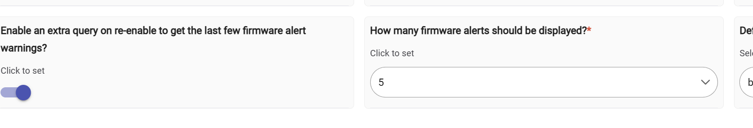

new version 2.30 in github
added option to set how many firmware alerts to display (not to be confused with the lastfirmwarealert which comes in via the websocket api).
Warning: All can be a lot of them..

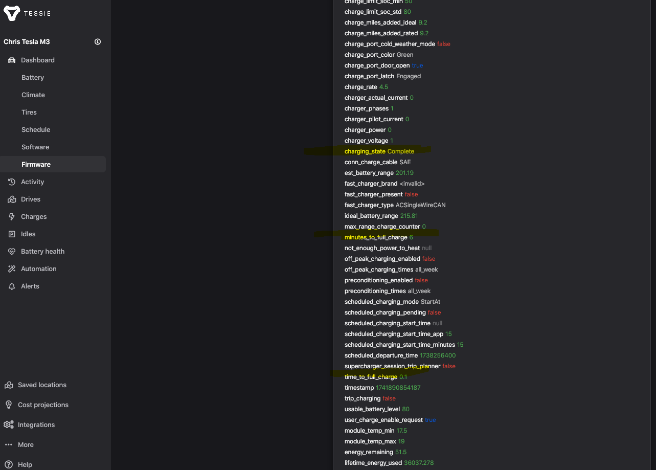

I ran across 2 problems which I'm unable to resolve, and I'm hoping someone can help me.
  1. The thermostatSetpoint seems to be stuck at 21C as the default even though I've changed it in the Commands
  2. I've set the current_charge_limit to 80%, and when the car is charged to the set limit and the chargingState indicates Complete, the Minutes_to_full_charge still has a certain value (mins) other than 0.
Thanks in advance.
#2 is normal, as that was the last known value Tessie has when the car was still charging. You will see this same value if you log into your account at tessie.com It is better to use the "Time To Full Charge" attribute as @kahn-hubitat has logic in the driver to have that attribute show "not charging" when charging is complete and when it is charging it displays in hours and minutes instead of just minutes.

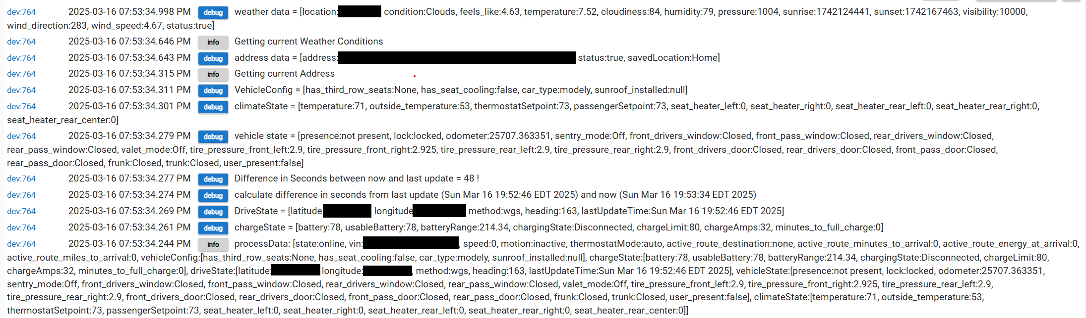

While testing after Bruce123's post, I found something strange. There are 3 temperature change messages in the logs per settemperature attempt AND the temperature in the device page changes to what you set, and then jumps back after a few seconds. Setting it again makes the new temperature actually stick. I have log screenshots from yesterday, but I can't get to them right now. I couldn't determine if there was a difference between the car being idle or awake. There were only a few random times out of dozens of attempts where the new temperature stuck the first time.
Until I can get those screenshots to you, please see if you can replicate that. On the device page, set the temperature to something significantly different from current set terp, e.g. 64 and watch the thermostat set temp and then try 70 or 75 and then back to 64. give it enough time in between each attempt to allow it to stick (5-10 seconds) and observe the thermostat temperature attribute. Sorry if it's not clear.
Migraining.
Here is my log.
I'm curious, as I'm using Celsius, but the log still shows in Fahrenheit. I wonder if it's the conversion.
