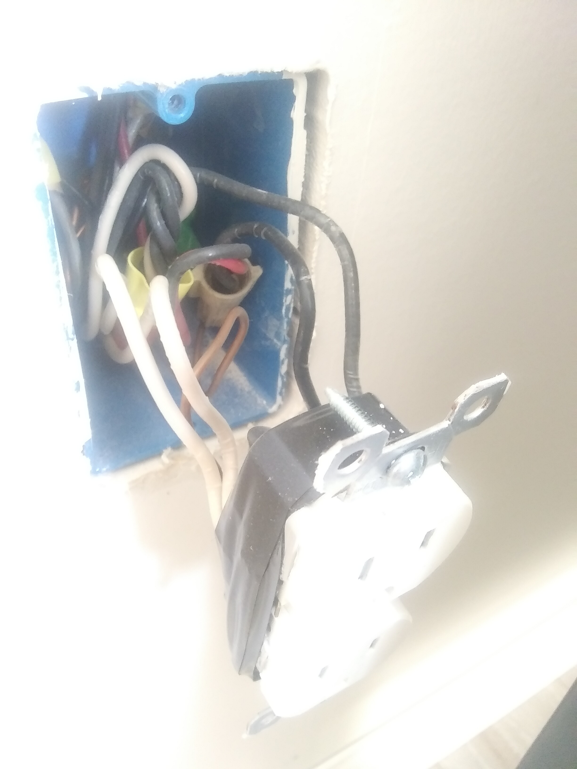

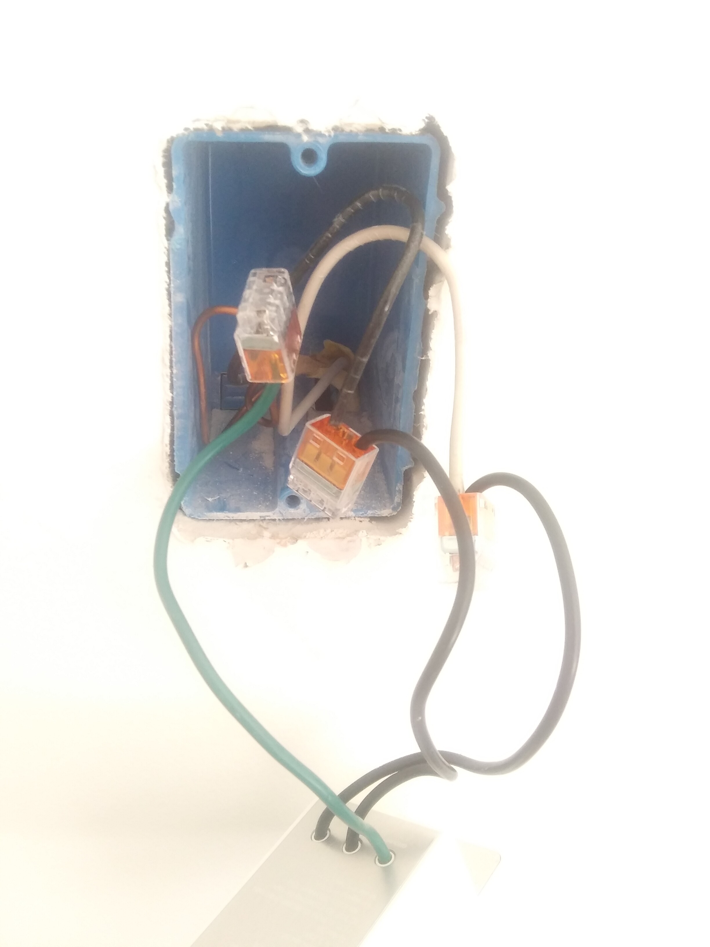

Actual outlet and wall switch ...
@rwin10 thank you for the photos, much better than diagrams. Need to confirm if you have a “half hot” outlet. See the circled copper tab, is that same tab on the right hot side of the outlet or has it been broken off?
If your outlet is indeed a half hot which I suspect it is given a single 14-2 Romex going to your switch, here is what I would personally do:
  • change wiring in outlet to send hot, neutral, and ground to the switch so you can install any smart switch there. This will be a smart with no load but supplying neutral will allow any smart switch to be installed there.
  • install a smart outlet in both of your locations where you want them switched
  • once installed setup a smart automation rule to toggle both smart outlets when the smart switch is toggled.
Another option is Inovelli just announced this scene controller that doesn’t require a neutral that can be installed in your switch location. But again this plus smart receptacles will be required in both locations that the scene controller would control.
The scene controller has many additional buttons and LEDs that you can use for other automation use cases.
