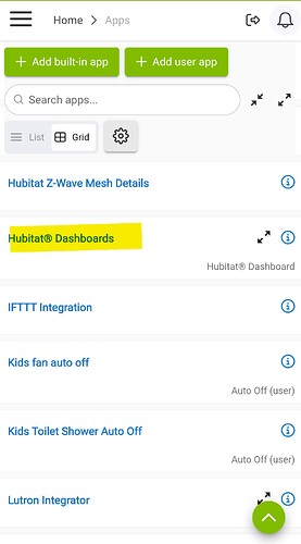

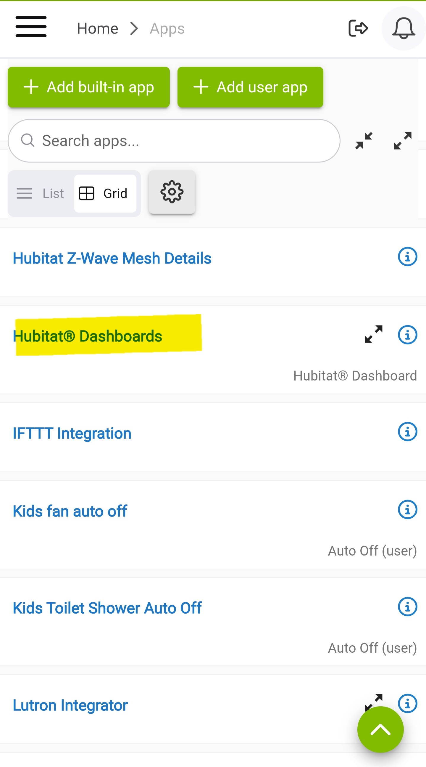

What is the "dashboard manager," and (if not clear from that) which dashboard app?
Additionally, where are you changing the name? Name changes on Lutron do not affect the Hubitat device, though I suspect that isn't what you mean.
The dashboard manager, where you add devices to the dashboard categoies.
Change name after adding the integration via the Lutron Integrator app on hubitat.
OK, so the dashboard app itself. (That is what is used to "manage" parts of Hubitat Dashboard, but there are both Hubitat Dashboard and Easy Dashboard, so that was also part of my question.)

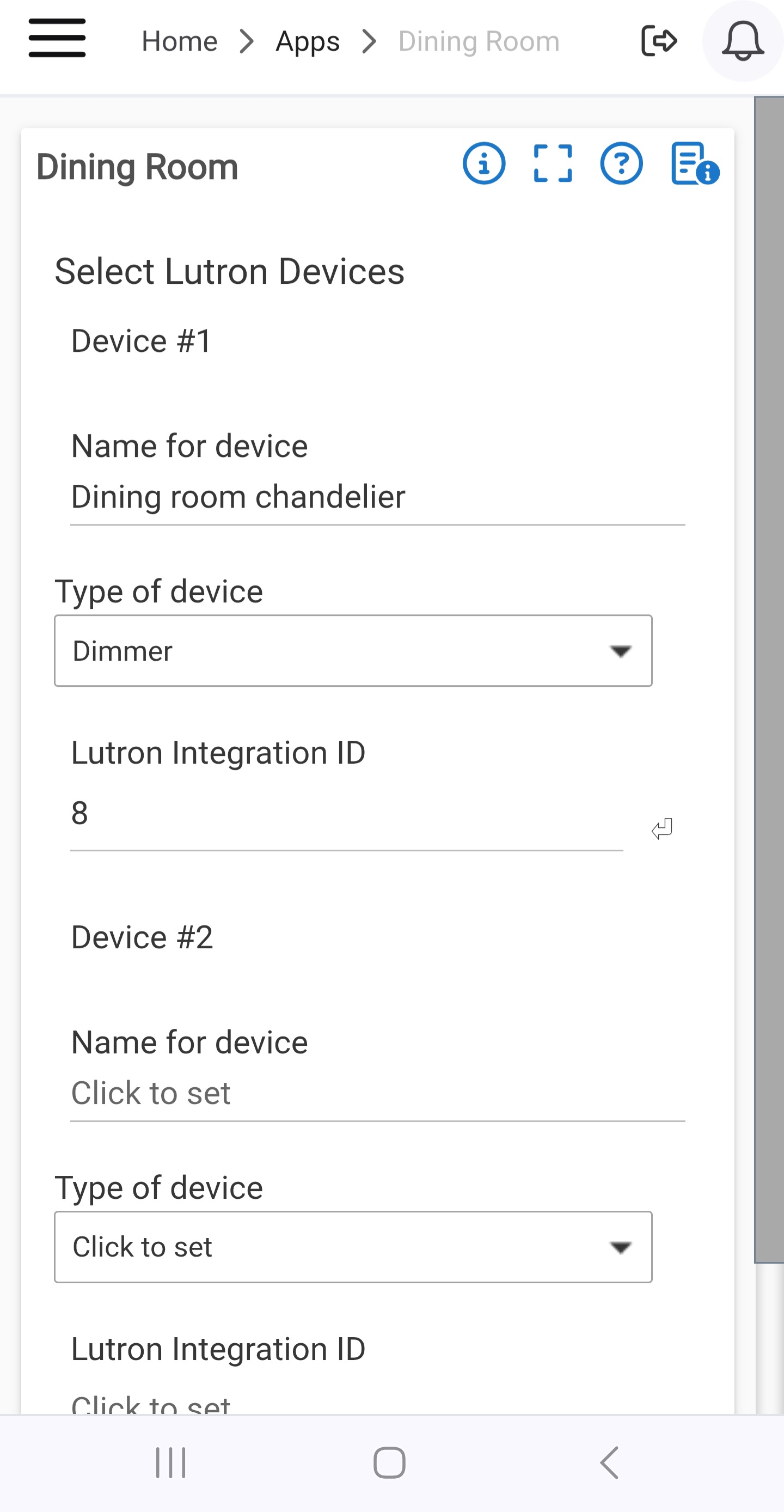

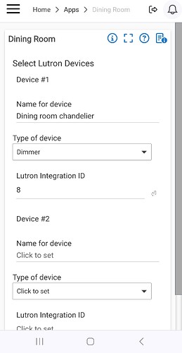

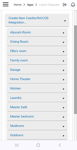

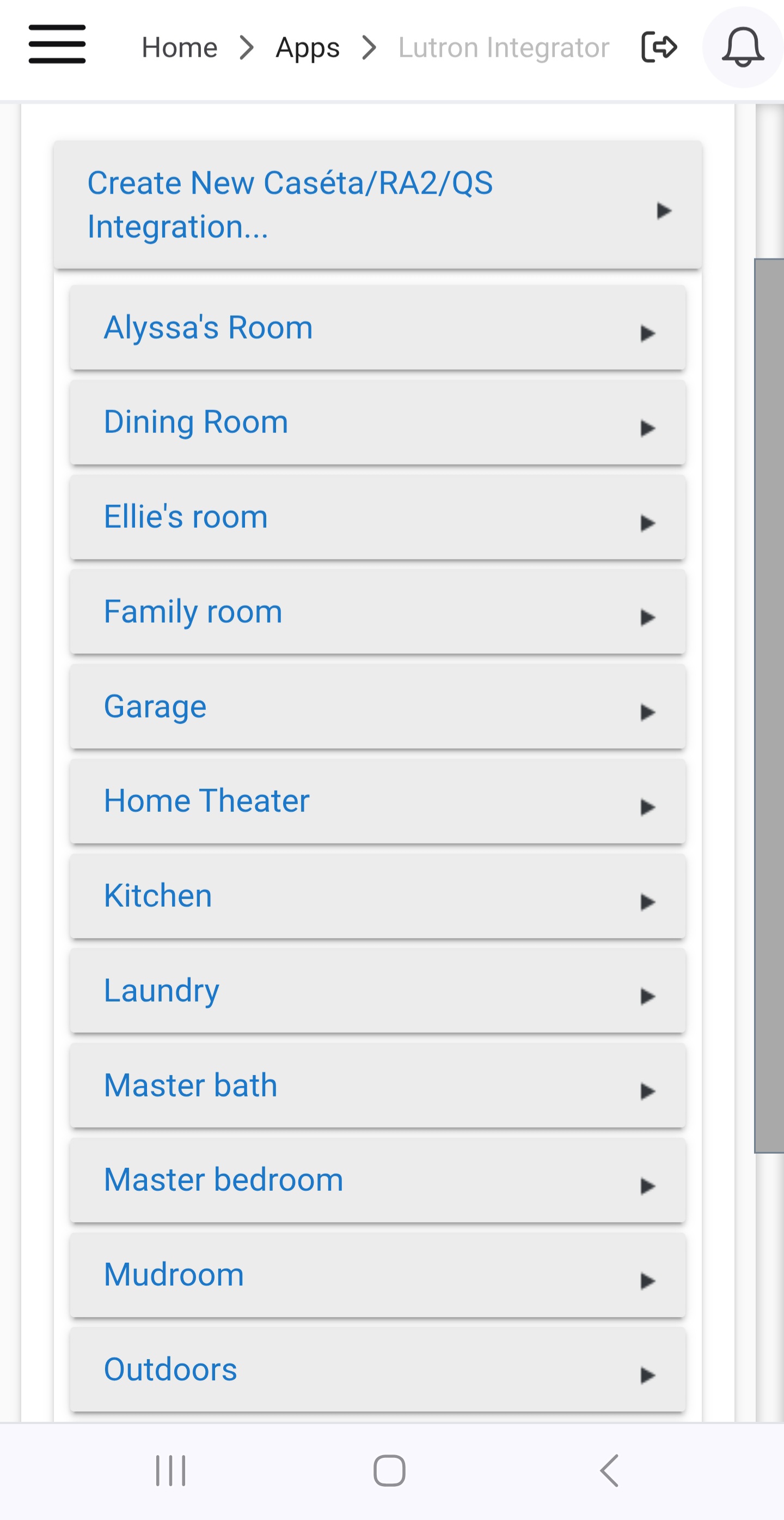

Your Lutron screenshot is also confusing. Did you really have 12 different Caseta (or RA2) systems in your home? That's what it looks like, and those names aren't used anywhere -- they're just for the app itself, and all other apps will see like Dashboard are just the device names that each integration ultimately creates inside. Assuming you only have one Lutron system, the correct approach is to create a single integration and then add your devices (maybe you have 12 of those?) inside that integration.
But either way: changing the name inside the Lutron integration app after creation, as you might be doing in that last screenshot, also isn't going to change anything on the hub that's already been created. You can rename it there too so things match if that's less confusing for you in the future, but to actually rename the device, you do it like any other device: from the device detail page.

From the screenshot above, the poster is using the interactive set up instead of the list. But either way, you need to do this because that won’t have any effect:
