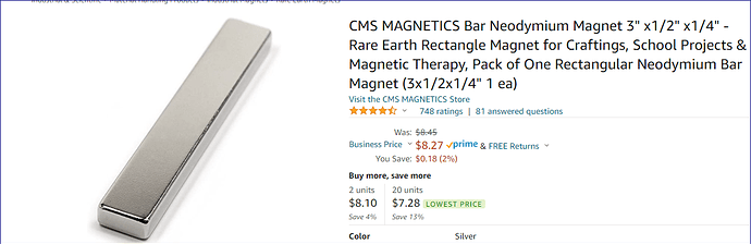

i use ecolink 2.5 contact on my fence gate with a wide gap but used this magnet instead of the default one.
Amazon.com: CMS MAGNETICS Bar Neodymium Magnet 3" x1/2" x1/4" - Rare Earth Rectangle Magnet for Craftings, School Projects & Magnetic Therapy, Pack of One Rectangular Neodymium Bar Magnet (3x1/2x1/4" 1 ea): Home & Kitchen
Unfortunately, (or fortunately, depending on the subject), I live in Canada:
In the US, this magnet is $8.27(US)
In Canada, this magnet is $76.57(Can)
