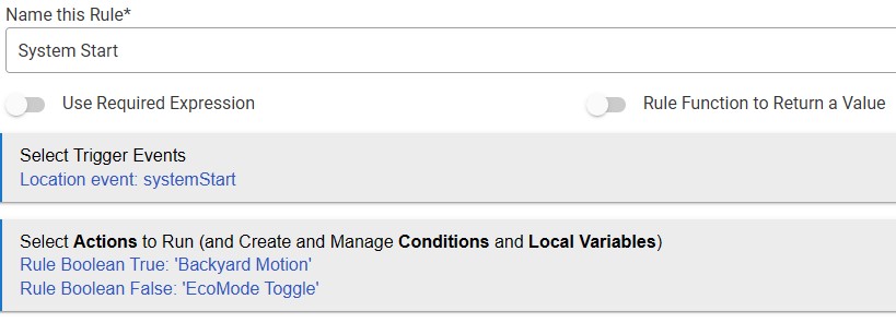

You might to take into account though that if the hub looses power and your in the middle of the "wait". You might want to reset the variable when the hub reboots?
I have a few rules that have time outs that I reset when the hub reboots

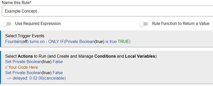

This may also work. I am using this with my Zooz 70 motion sensor which likes to double event on motion.
except for you want to change the boolean to true at time out.

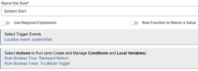

Then as oldcomputerwhiz mentioned, as a safeguard to your hub rebooting during the delay, add this little example in.
So you are at a known starting point for a system start

I wrote a simple rule to test this theory and what I'm seeing is that any delayed actions that are scheduled before the reboot do get executed after the reboot. @bravenel is that true in general of scheduled jobs?
Of course. Reboots don't affect app state, other than (a) the hub is gone for a couple of minutes, and (b) there's a systemStart event after reboot. Otherwise, rebooting is a non-event for apps, and whatever they have going on...
Ok, I implemented the Private Boolean and created a conditional trigger. In doing so I was able to recreate the rule without the expression and the virtual switch so the rule now seems more efficient and seems to work the same. I'm going to apply this to some of my other rules I use virtual switches for.
