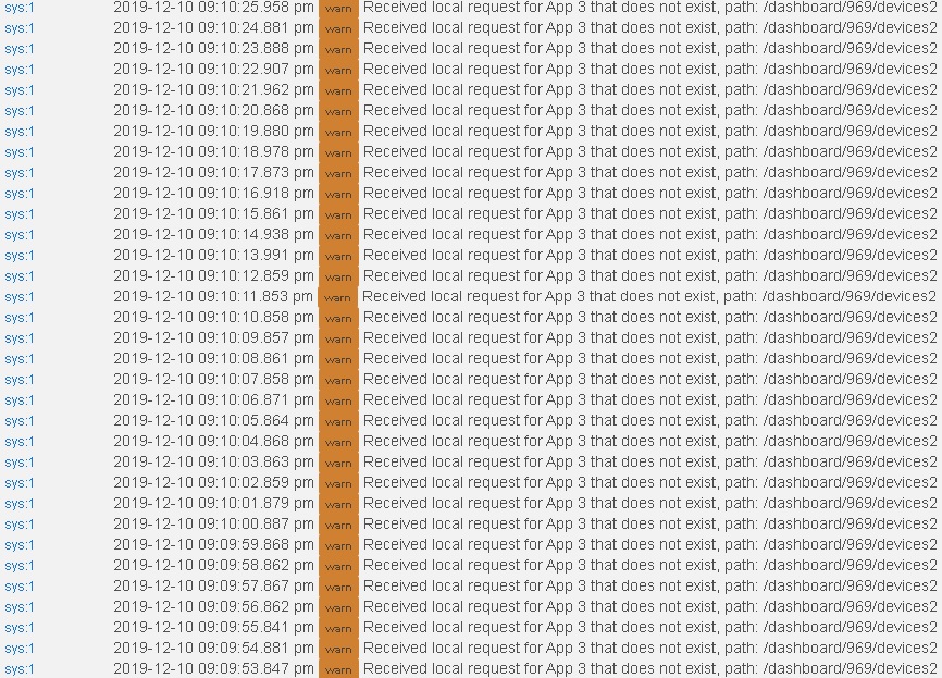

I deleted Hubitat Dashboard, and now I'm receiving the following:
Tried reinstalling the app to no avail...
Tried restoring a backup and then deleting the app again - same issue... Not sure if I should open a ticket for this one.
Something, somewhere is trying to open the dashboard. Do you have a web page open to the dashboard somewhere? Hubitat App? Wall-mounted tablet? Phone?
Why yes indeedlydoo I have a wall-mounted tablet.
Well, there you go. You can't delete the dashboard app and still access it from a wall mounted tablet.
Perfectomundo, thanks!
No problemo. :wink:
