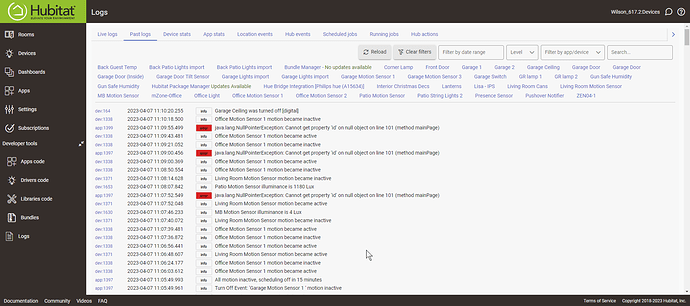

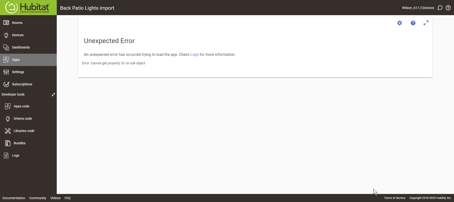

This isnt workin. I can get the Rules exported (though for some reason one wants to export as a text file) , and imported, but, but when I go back to look at the imported RL , im getting unexpected error messages.
