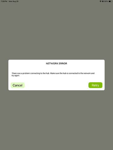

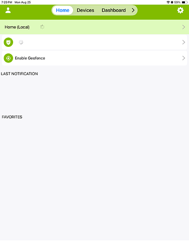

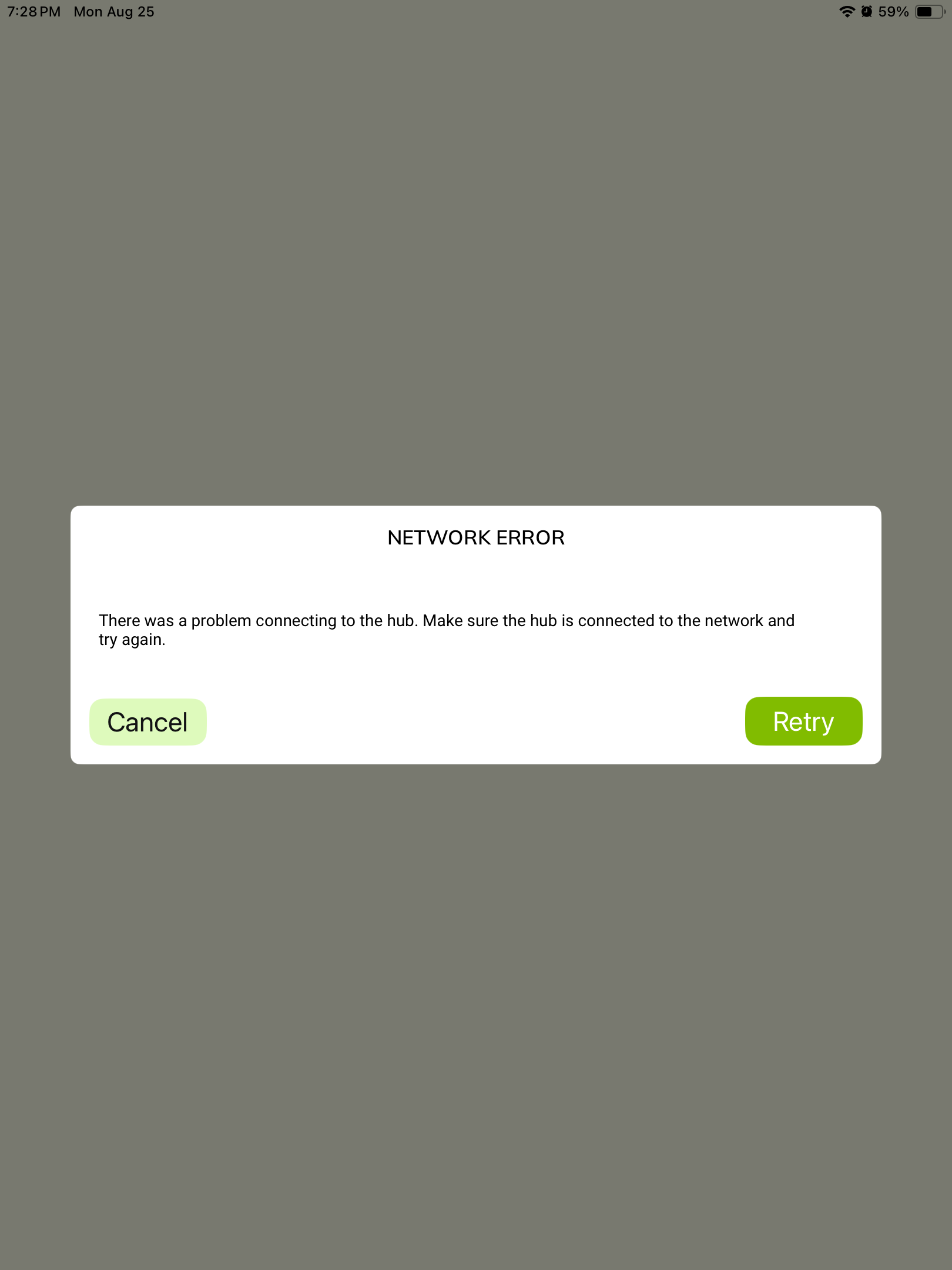

I am having a connectivity issue. I can access my hub and dashboard but after a a few seconds I get this message over and over.

Sorry for the delay. It was the new app that was the problem since I have an older version of the hub operating system.
