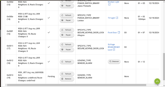

It would also be a good idea to look for ghosts in your Z-wave list, but this is only available if you have a C7 or newer hub. Post a screenshots of your Z-wave details page, so we can see if you have ghosts. You didn't say which hub you had, so I am going to assume you have one of these as opposed to an older C5 which doesn't have the details on this page.

I have the Hubitat Elevation® Model C-8 Pro.I might need to update my locks. Do you have any suggestions for a good brand that would work? I do not know how to upload the Z-wave detail page, and I could not find anything about ghosts.
Go to Settings -> Z-Wave Settings, and take a screenshot of the entire page.
I have the screenshot. How do I attach it to this message?
When you're in a compose window on the forum, you can use the instructions below to attach a screenshot or any other image.
You have two z-wave ghosts (0x0011 and 0x0013). You will need to remove these for stable z-wave operation.
Also your Schlage locks are pretty old - one of them is a BE468 and the other is a BE469NX. Neither of them are z-wave+.
