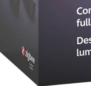

@walberg61 The connectivity of those is wifi with bluetooth and require the Hue bridge to work (This is similar to how their Go lights work) They are not zigbee as one would think.
You must be thinking of Philips WiZ light bars, the Philips Hue Play bars use ZigBee.
Yes i know and of course i never used Wiz. No i have the Zigbee version and i had them on a Zigbee stick
Hmm, the ones I looked at (the phillips) were wifi/bluetooth
Strange... Perhaps different model.,,.,.
8718696170724 Is the ean. Search for it. And it is Zigbee
I believe you... I must have been looking at the specs of a different mode...
