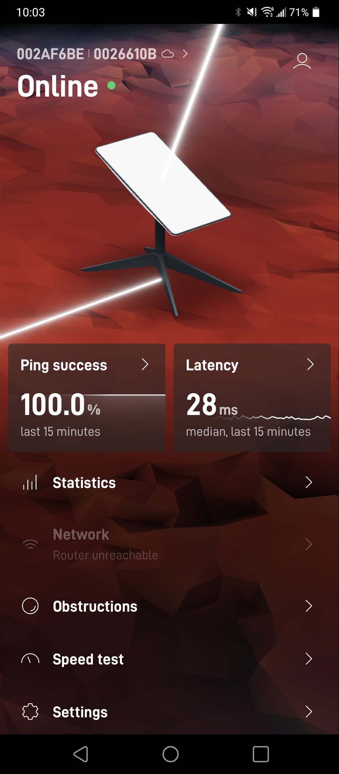

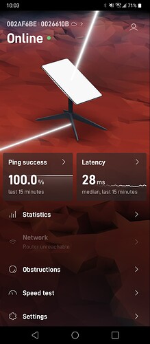

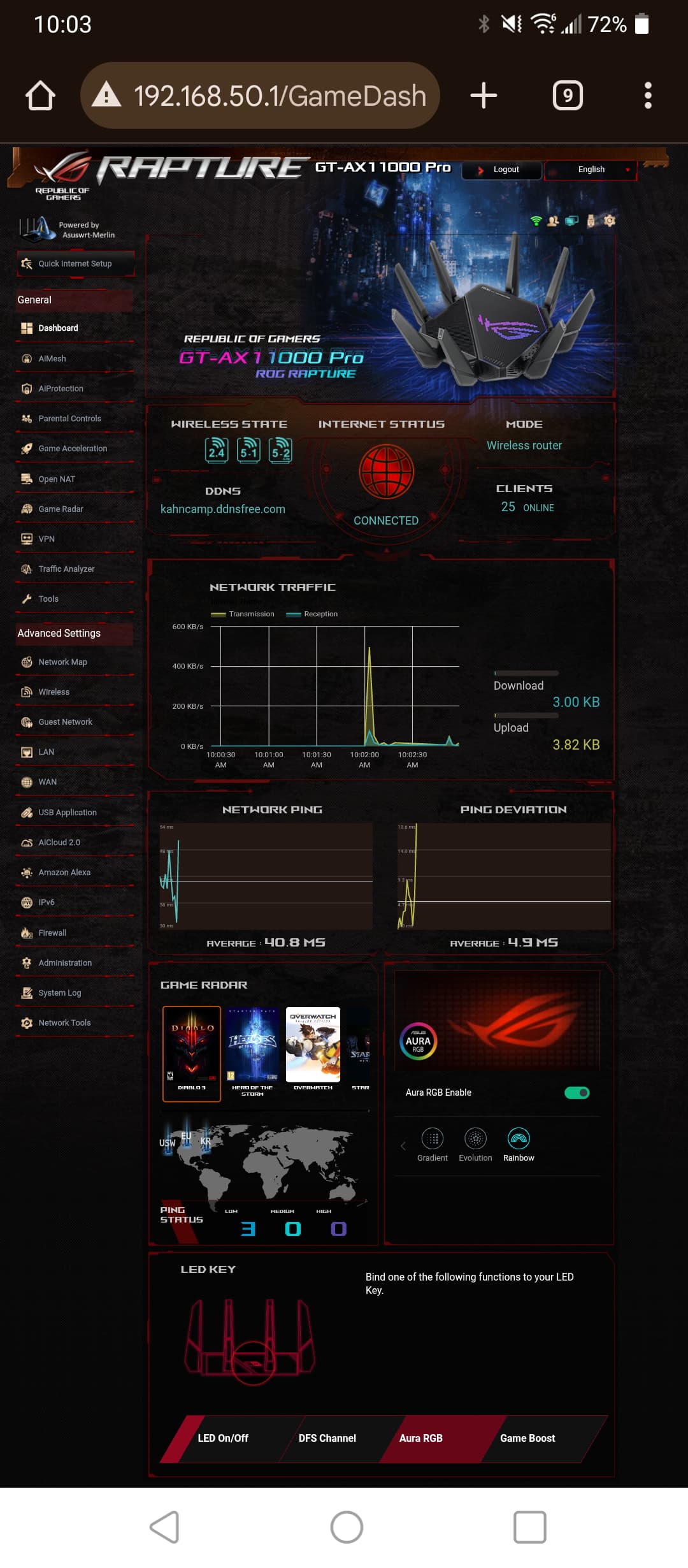

Put starlink modem/router in pass thru/bridge mode and put a real router behind it. I have an asus gtaxe11000 pro router behind my starlink.
I have the Gen 3 Starlink in my RV and it really is a POS. It's really locked down and not much you can access except for bridge mode. I had to add a small pocket router just for some basic things I needed to do.
