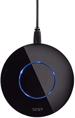

The only thing I have found is a device called BOND which seems it would allow me to use Alexa and Google Home etc but not sure if I could use Hubitat?

Bond is supposedly working on integration with SmartThings, once that's done it probably wouldn't be long before someone ported it to Hubitat, however to really have the control over the fan and lighting you would want, your fan's remote would need to know the current state (usually those that do have a display that shows the current state) otherwise if you turn on the lights with the remote that wouldn't be reported to Bond and Bond would still think the lights are off, which would keep it from turning them off when you left the house if you had an automation setup to do that.
Remember, bond would not be able to know about local changes made to the fan with an RF remote. It would only be able to know about it's own changes to the device. The same is true of any RF or IR interface device. So, they are much more unreliable than a directly connected controller. For example, the Hampton Bay controller has an RF remote and local changes are reflected in the Zigbee connection as well. So, for more money you are getting something more unreliable. I would definitely go with the HB or the bond.
I have found my fav device for ir and rf is the broad link. It works amazingly well for me. is cost efficient. And as others said keeping state is not easily accomplished so I do not bother. So basically I have a "universal remote" that is linked to Alexa via node red

I can tell you aren't looking to REPLACE your fan controller(s) in the canopy... I certainly get that!! However, it should at least be a consideration, in my opinion. Broadlink was one I 'hovered over' while dithering which to buy. If you're not going to replace the canopy controller, I'd go Broadlink over Bond.

I tried Bond, and didn't really like it. Sure, it allowed me to use Alexa to turn on and off the fan and light, I couldn't dim the lights with Alexa. I could dim the lights with the mobile app. If I used a wall remote to control the fan or lights, Bond wouldn't know the status. All it really does is toggle between on/off. So, when using a routine in Alexa to turn the light off at 10:00 PM, it would sometimes turn it on.

I have Bond and have integrated it into HE by creating virtual switches using IFTTT. It works but you can get them out of sync if you use the RF remotes or the wall remotes some of them have, but I always turn them off with everything else on a 2:30am routine.
Bond is limited to one way communication (sending commands only) by the remote control module your fan currently has installed. There are remote control modules which allow Bond to know the state of the fan/light and provide that feedback so if you tell it to turn on and it is already on it won't turn off. Bond also makes their own module now that provides that capability as well.
Currently Bond doesn't work with Hubitat natively so your solution is great since you had the wiring needed already in place.
