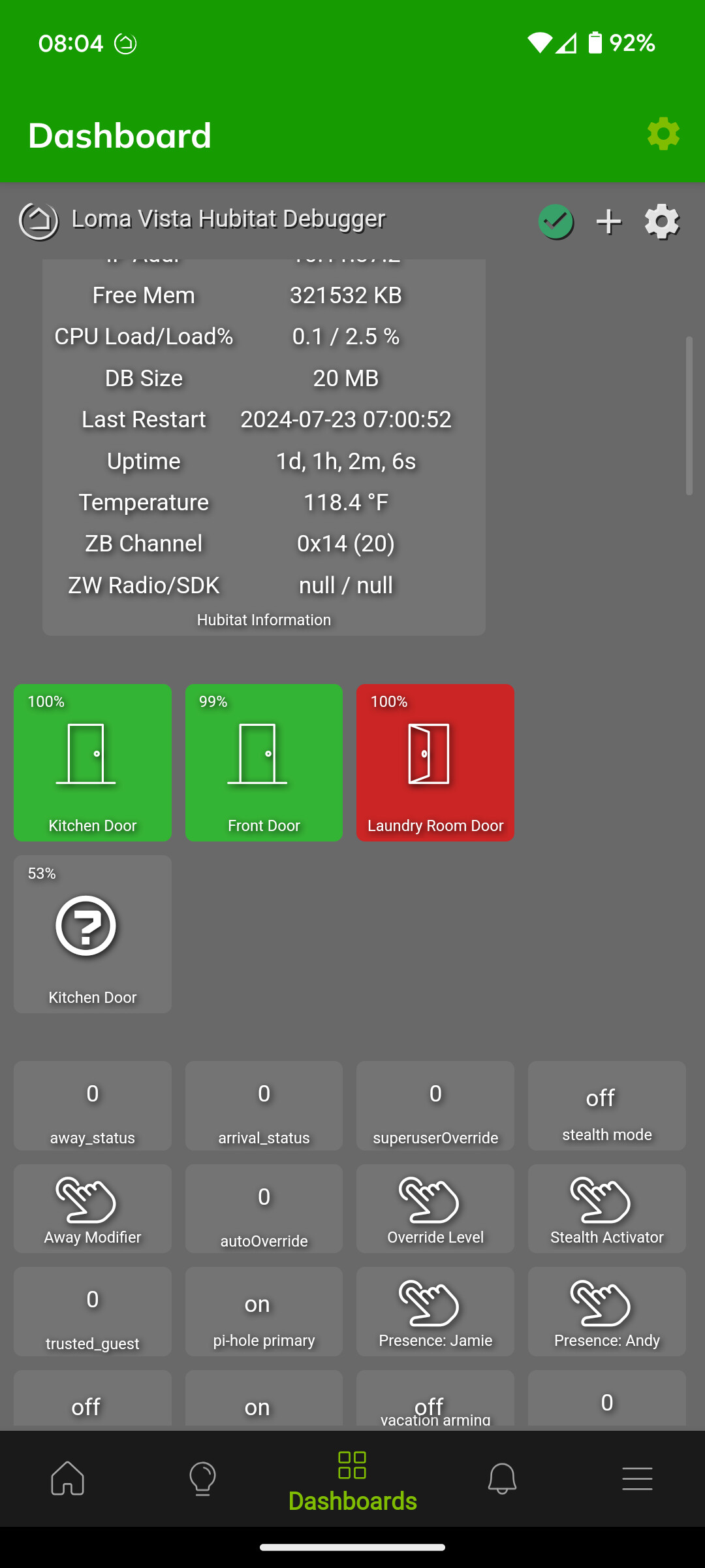

Huh, I'm using Hubitat's built in generic ZWave driver and it just reports some code from the lock with a note that says "what is the lock state?" or something of the like in logs but does not change the lock to "Unknown" when lock jams.

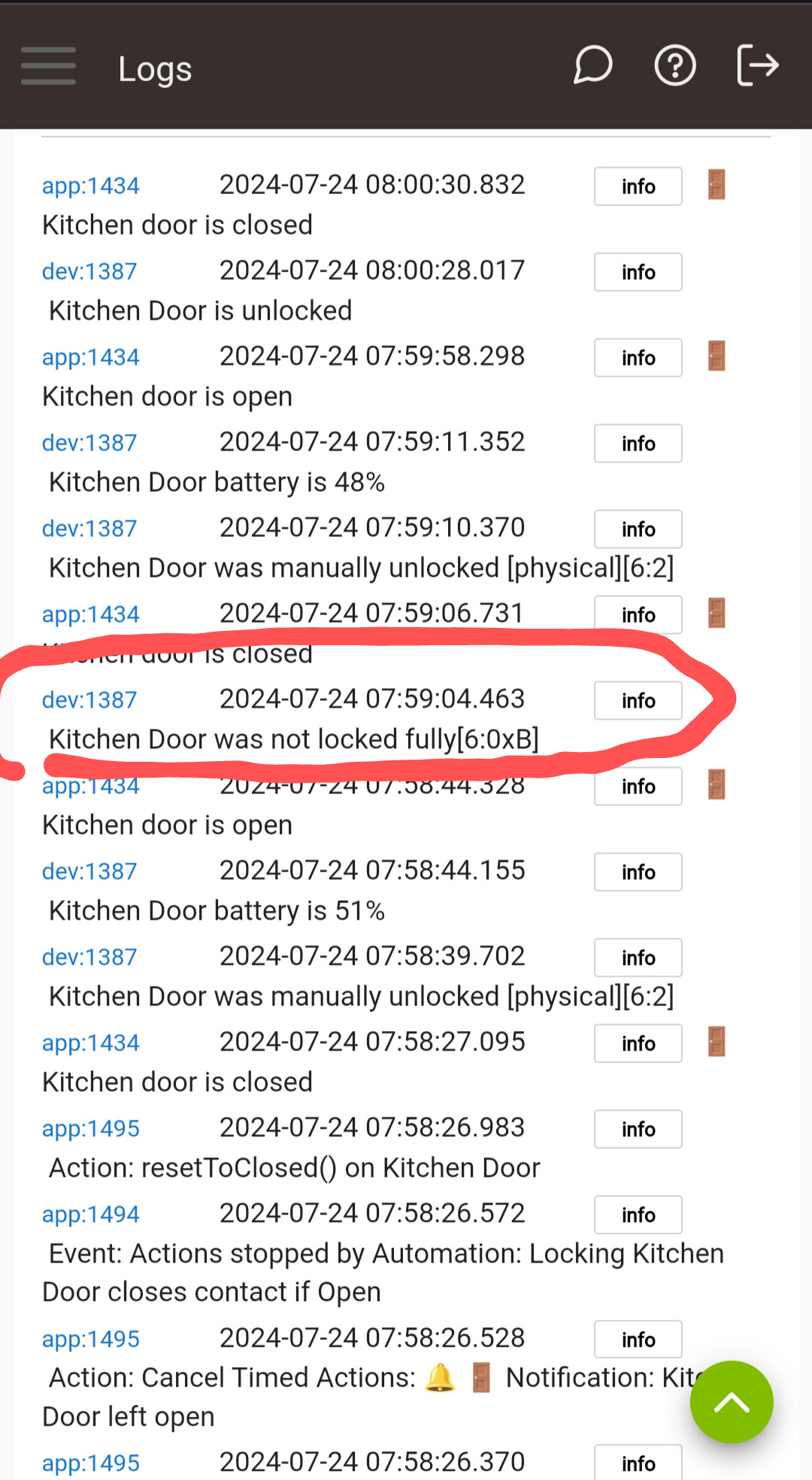

Interesting development. I took this screenshot several months ago where it showed the message I got when the door jammed. Just last week, my Yale Assure Lock 2 received an OTA firmware update when I opened the Yale app on my phone. Today when I intentionally jammed the lock to show you the log output, it seems to no longer report this in my logs. Maybe it's no longer able to report a lock jam?? Geez I hope not. Oh, I'm on 2.3.6.146 Anyway, here's the log from a few months back:
different lock models and firmware can produce different codes, in any event the next build will parse 0xB as unknown.
