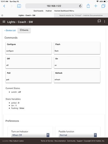

Hi. Just wondering what rhe configure button does in devices? I looked in the help section but configure isnt even listed as an option.
Just trying to understand the options better. Thanks.
