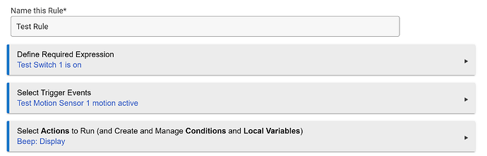

Manage conditions is just that, it is where you create and manage your conditions. You then need to employ those conditions in the rule, either as a required expression or as conditional statements in your actions.
For your use case I suggest required expression = virtual switch on.

I deleted my managed condition and just used the required expression (aka condition) thing and now it works as i expect it - though my OCD is kicking me as this feels icky and unintuitive
This is exactly how conditional actions work. The suggestion above of using a required expression is one way to avoid needing to do this that would also work for your particular use case (and save a bit of clicking).
This allows you to view and edit conditions that you are already using, or to pre-create ones you want to use later. When creating a conditional action, wait for expression, or in other places you can use a condition, you'll see existing conditions as available options. This also allows you to use the same condition in multiple places, and changing it here will change it everywhere.
This box is a common point of confusion, however. It does not do anything on its own, as you now know. Some wording was recently added to the UI to suggest this, but it's also clear in the docs. I'd suggest reading them for Rule Machine; it's a large and complex app, and it might save from clicking and guessing.

You have to use them in an expression/condition, for your use probably a conditonal action (IF THEN). This is done via the menus to add actions. This video is a bit old (Rule 4.x), but it's more or less the same aside from the fact that actions are now shown in tabular format and added with the "+" button at the bottom of the table. Could be helpful if you want to see a video:
Also, I'd recommend just creating conditons as you use them if you're just getting started. Ignore this box. Pre-creating them probably just adds complication, but once you see how it works, maybe you'll change your mind. (I normally don't, FWIW.)
