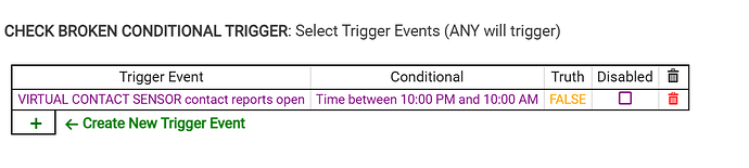

Conditional trigger broken in recent C8 pro update
C8 Pro on 2.4.1.176.

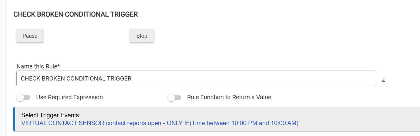

The recent few updates seem to have broken conditional triggers.
I created a simple one and it doesn't work properly.

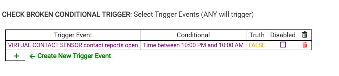

See below. When the trigger occurs, the action is to just speak "test" in my speakers.
Current time is 7 PM. So hence the condition fails as shows under truth column. Shows as FALSE.
So since that condition fails, it should not trigger.
But when i open the VIRTUAL CONTACT SENSOR, the actions fire. That is incorrect. Can this be fixed asap please. This bug has broken many of my time conditional triggers.
Before the recent firmware updates, it worked fine.
Kind regards

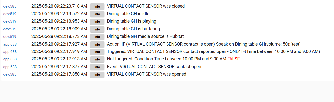

Can you turn on logging for the rule and post a screenshot of the hub logs when you trigger the rule?
There have been changes. Did you try opening the rule and clicking 'Done' as advised in the release notes?
Please update your hub to 2.4.1.177; this should work with that release.

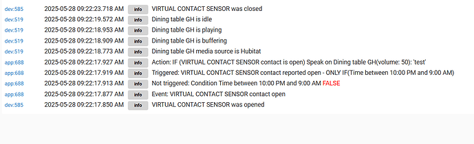

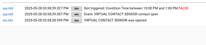

current time = 9:22 AM
notice how it says not triggered, but it does trigger.
