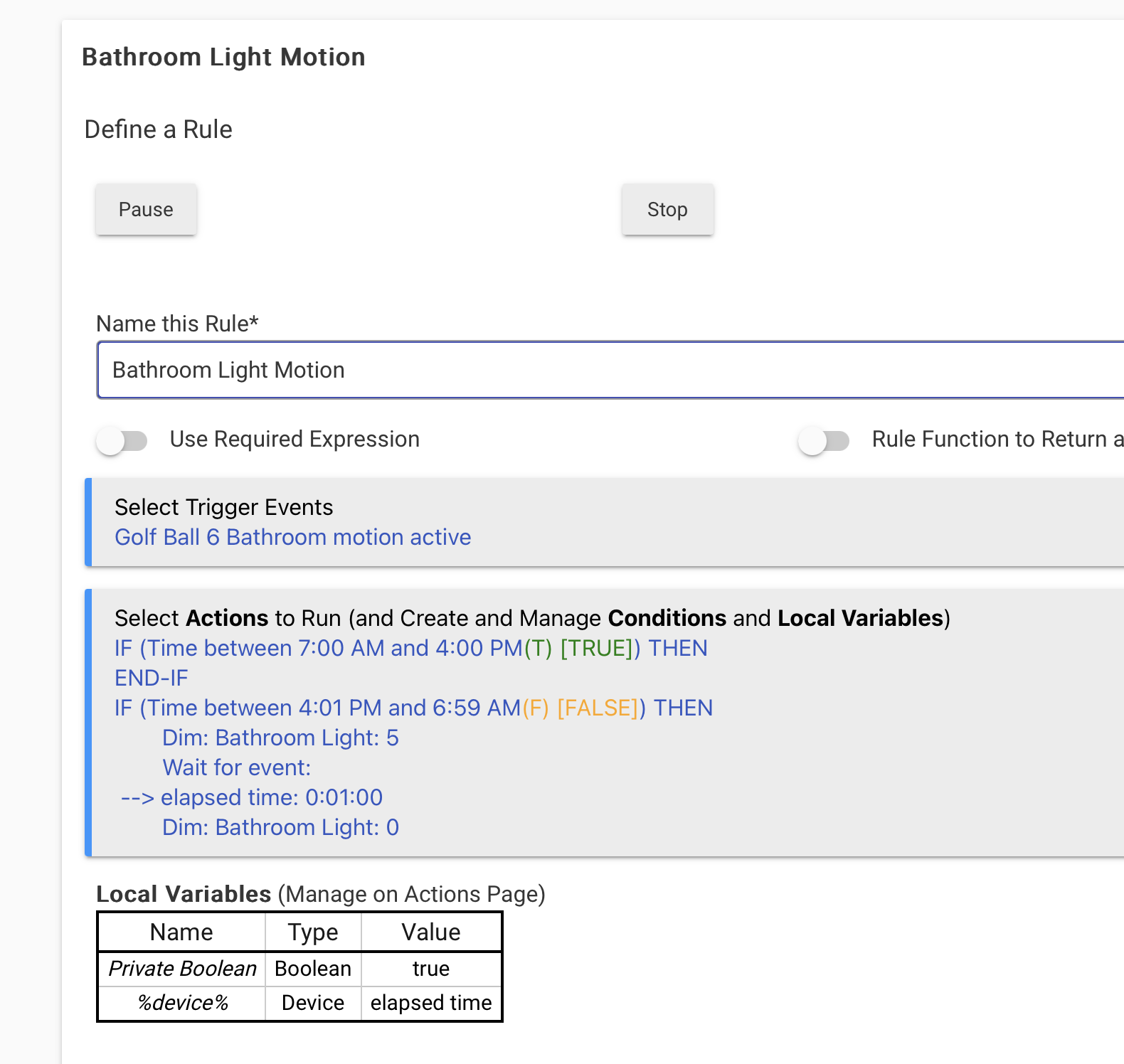

I'm trying to have a bathroom light come on when tripped by a motion sensor between 4pm and 7am? I'm hoping someone can help me figure out why this does not work.
Which part of the rule does not work? Do you have logs of the rule? That is usually the best place to troubleshoot issues. With that said, I'd strongly reconsider the way you have this rule written. If this was me, I'd write it the following way:

The lights go on with motion any time of day and do shut off after 1 minute.
I will try it like that.

Do you have any other rules controlling the lights during the day? Your rule should work; though, without logs and possibly device events, it's tough to say exactly what is happening.
Yes, I have several rules that are strictly schedules. None are conditional or that include that bathroom light. Good to know I'm on the right track. I looked for videos and the support info was spotty. I will use the Motion Mode app for this until rule machine is working for me. It seems simple enough going right down the list of conditions and actions in order.
