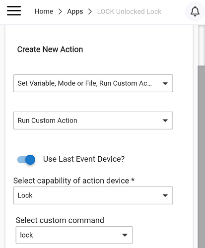

I thought this would work in RM, using Custom Action > Last Event Device > Lock as shown...
For a single device and event, yes; the OP made it sound like they were looking to collect and act on a list of devices matching a certain criterion. I suppose we'll see!
