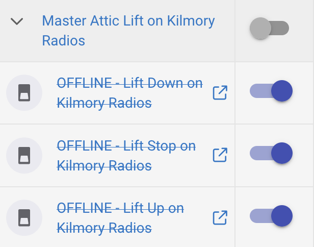

@gopher.ny I run 2 production hubs and every time I add a new component device to my radios hub and share it with my coordinator hub via hub mesh, the child components come over as disabled:
Clicking the disable toggle temporarily enables them and then they disable again.

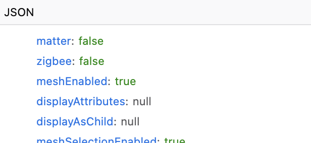

@gopher.ny Sorry misspoke even though hub mesh is enabled on the parent Zen16 on my radios hub (source hub):

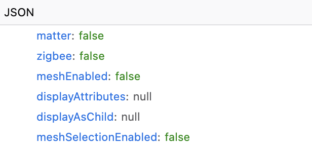

It is NOT enabled on the child component devices:
Because of this my target mesh Coordinator hub has these devices disabled. As mentioned I can perform a Post request to "/device/update" on each of the child component devices setting meshEnabled to true on the source Radios hub to fix it but obviously this shouldn't be happening.
