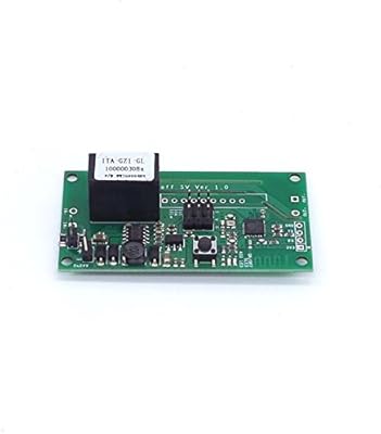

There are low-power (5-12v) switch options but they all require power 24/7 as they use WiFi and are even more power hungry than zigbee or z-wave. But of course, they run off 5v power so it would be easier to run wiring out to the pump in the front yard rather than running 120v AC out there. Depending on how many batteries your pump uses, you could run the pump off the same 5v supplied to the controller. Or it can act as a regular relay. If we aren't talking a very long distance, this would probably be an option.
