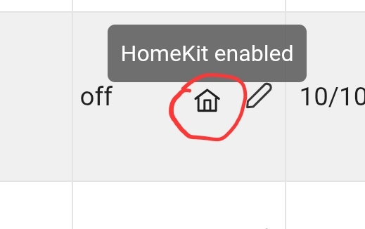

I like @Busthead idea, maybe not a separate column but a logo on the Status column, much like the home icon for the Homekit enabled devices.

1000012894
