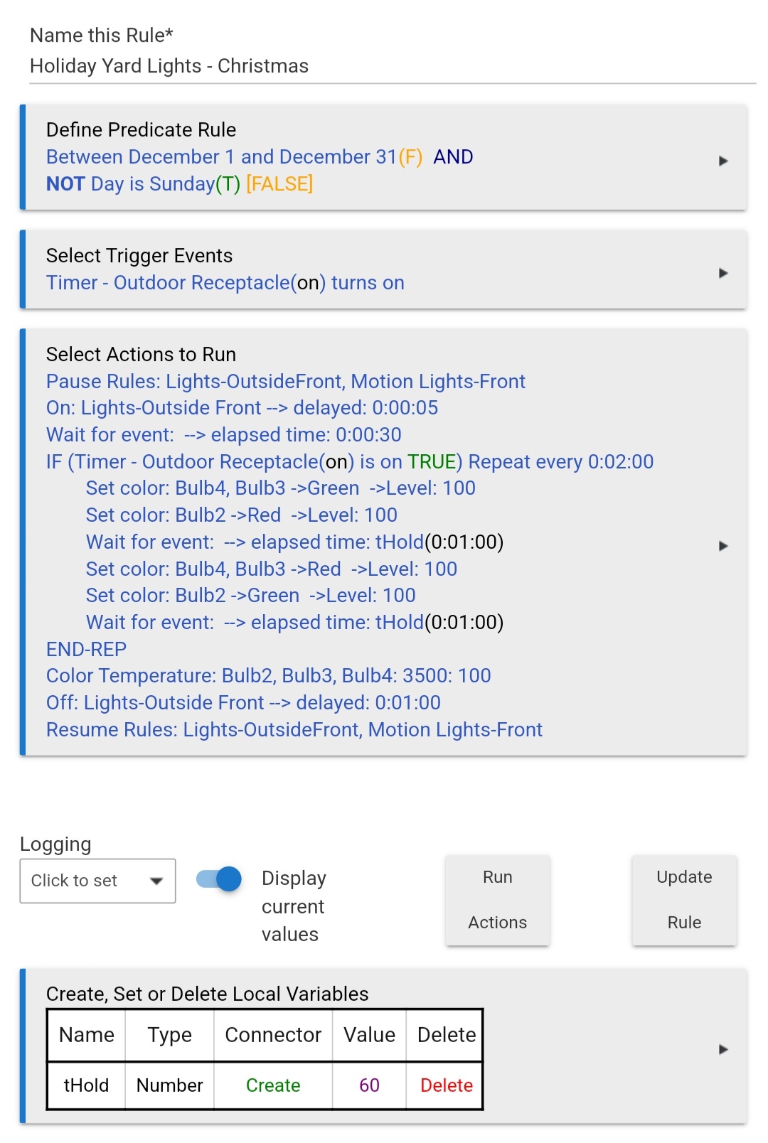

Here's my version. It's triggered by a smart plug that I use to control some outdoor holiday lights. When those lights turn on, this rule runs in a repeating loop until they turn off.

Just to close the loop. Very happy with my color cycling rule. Here's the final in case anyone cares.
