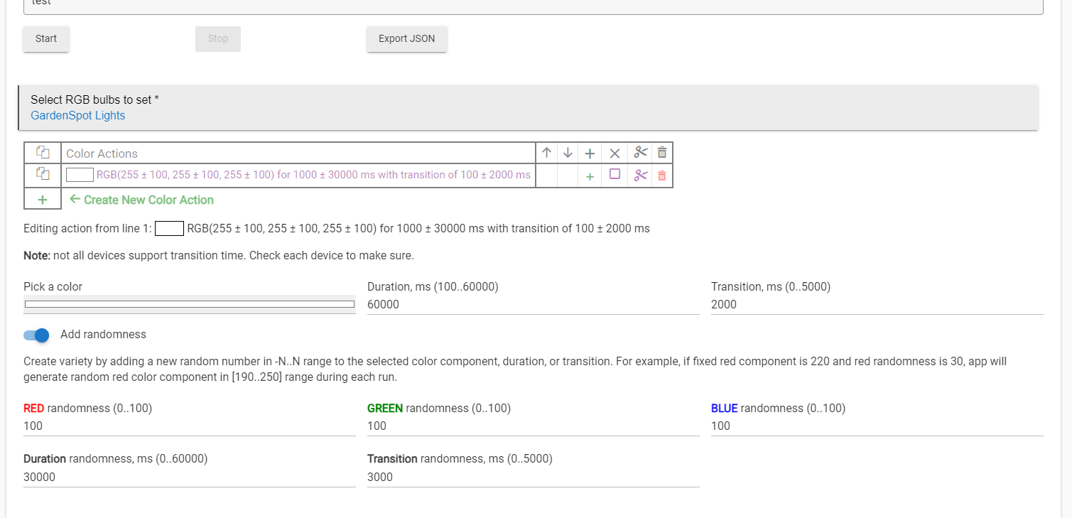

  1. seems to not work correctly with duration.. i have 60000 with a 30k variability which to me would me eachs lasts one minute +/- 30 seconds.. see logs it is very quick changing...
  2. on that note i want longer times that one minute.. i sometimes like scenes to last 15 mintes etc.
thanks
@bobbyD
figured out part one.. rule was different thqt displayed params.. hit save again and that works.. no if we could just get longer times avail. thanks
