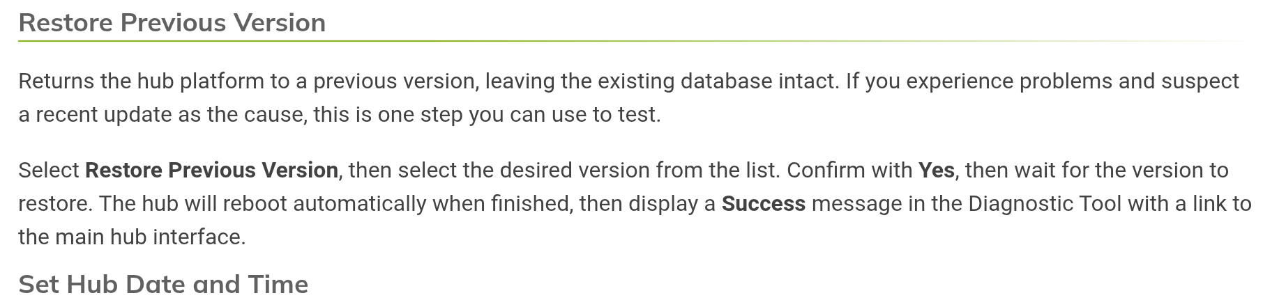

I haven't done this in a while. Do I need to get into the special boot menu to roll back firmware?
if you mean the diagnostic tool, then yes:
I'm fankly not sure how this may (or may not?) work w/the Z-Wave FW update removed after your cloud backup was completed on your original C8-Pro w/the newer Z-Wave firmware.
Tagging @support_team in case this is a special case...not sure.
That said, the roll-back of the new hub to .112 is worth trying.
