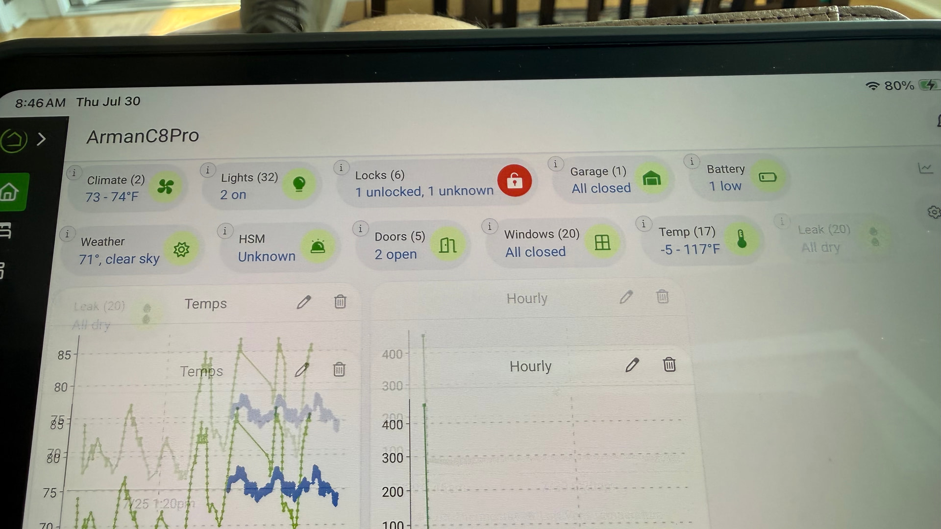

If I have certain devices, like openweather, on my home screen, the Home Screen, for better words, “jumps around” constantly sort of like a vibrating table. It’s hard to explain the phenomenon.
But if I take the open weather app off the home screen stabilizes. It’s as if it keeps trying to refresh, with some small change in the layout, causing it to refresh again.
It would probably require a short movie to show you.
