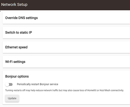

Check this setting...if it's on, turn it off.
So far reports back from users indicate it isn't messing w/HomeKit or Hub Mesh in any significant way, and should help eliminate or minimize Cloud connection issues.

I'm on 2.3.9.193, and my Bonjour options slider is set to off.
