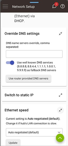

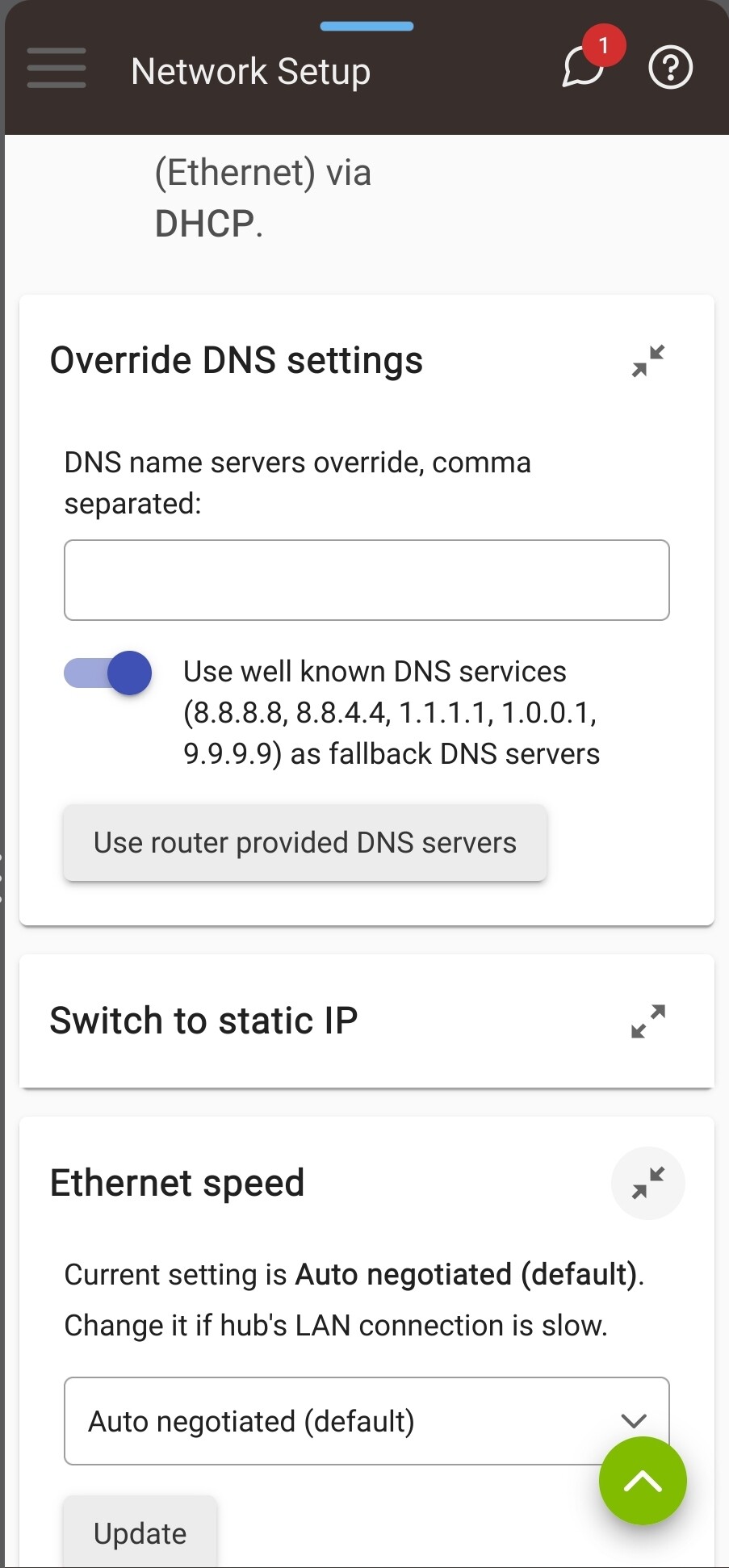

For giggles in network setup change your network speed to auto, and click use router provided DNS servers and see if that helps.
Nick Offerman Smile GIF
Copy that, thanks for the response.
Done and done, will report back when it fails again.
I did tap the use router DNS settings but the box is still empty. If that's normal?
