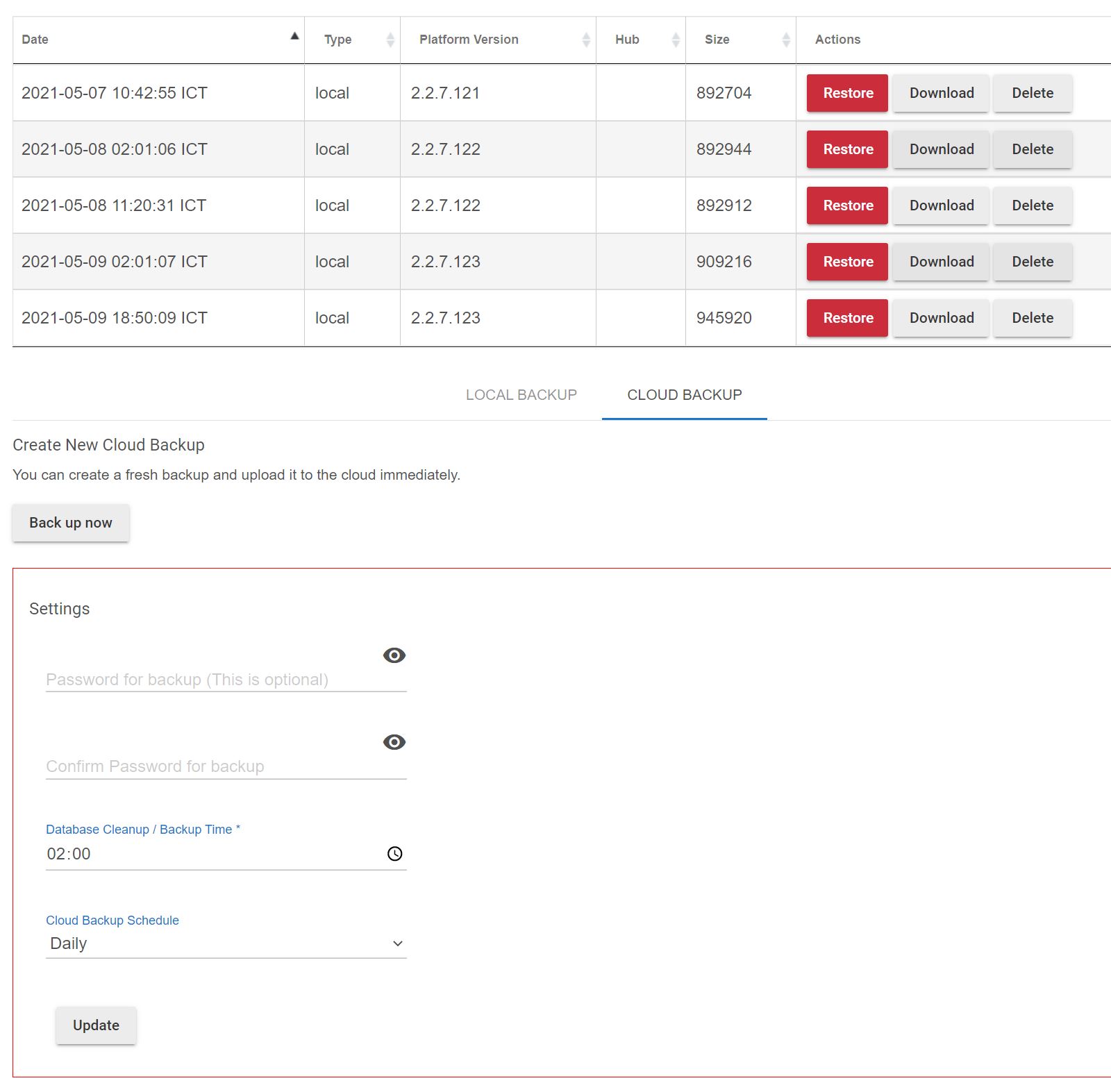

Initially, it worked fine. However, I have just noticed that all the visible backups on both hubs say 'Local'.
I am not sure if the backups are happening and I just can't see them, or if they are not happening.

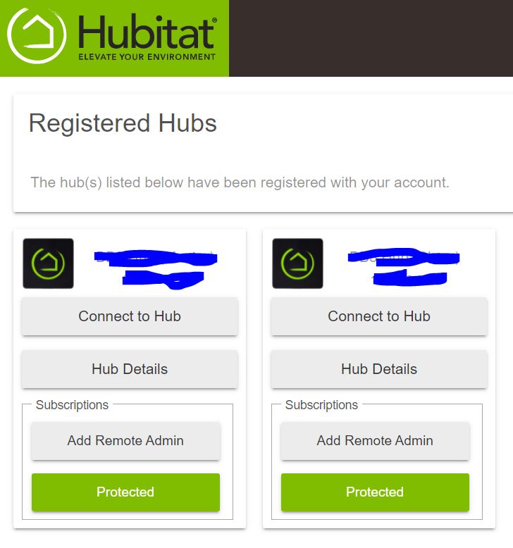

Okay, and just to confirm, when you go to the “Registered Hubs” screen, under subscription, you see the green “Protected” button? When you click on it, it brings you to the “Subscription” screen and you are able to see the active status?

The Hubs are both Registered for Backup protection and obviously, they have not expired.

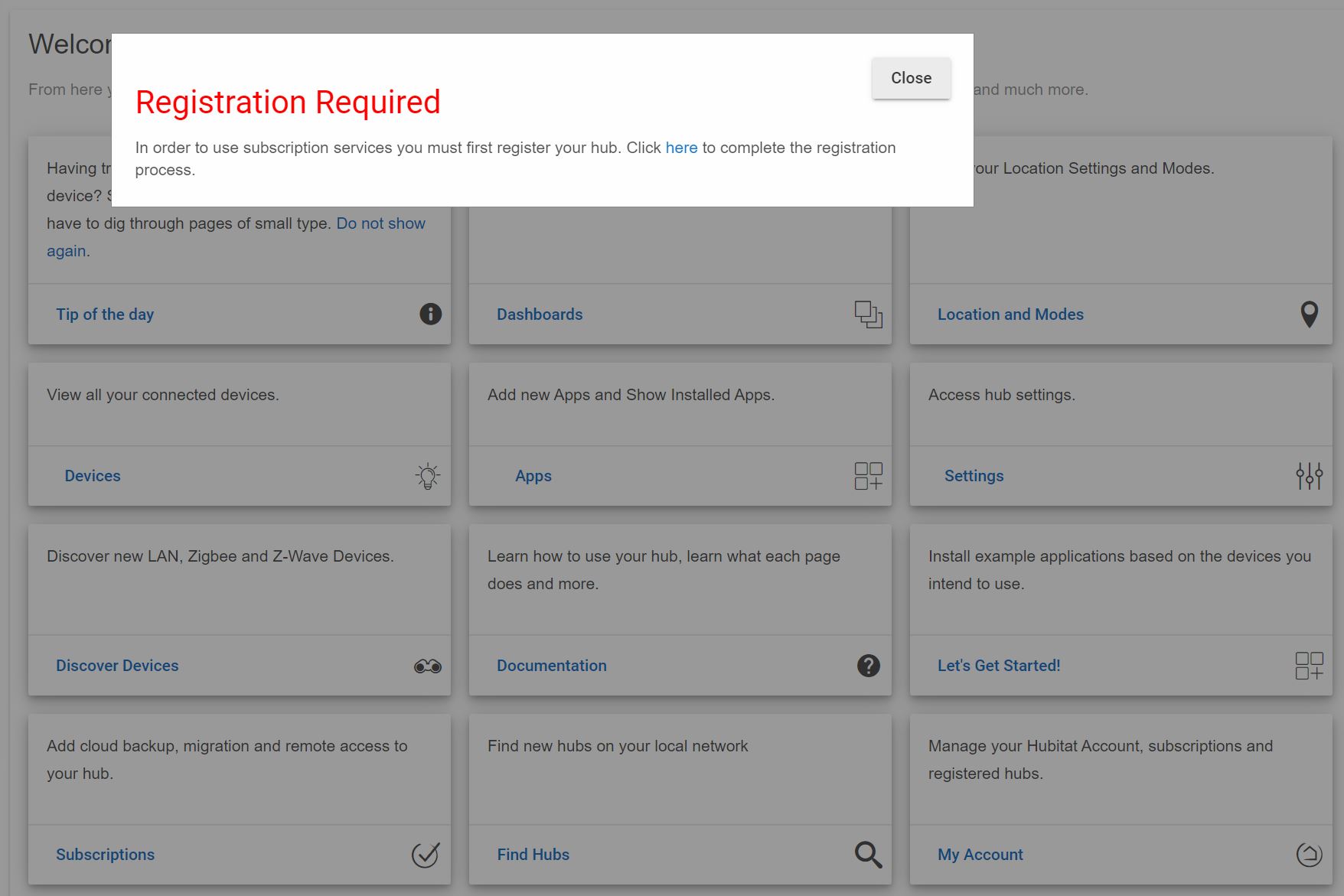

Something is definitely not right. If I go to the subscription box on the hub and click it. It tells me registration is required even though both hubs are registered
