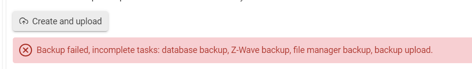

I'm trying to migrate from a C8 to a C8 Pro, but the cloud backups keep failing (incomplete tasks: database backup...). I have read through various posts and tried everything I can find for example:
Shut down and up plug (I have tried this 4 times one of which was shut down for 5 mins).
Truncate Event Tables: http://HubIP/hub/advanced/truncateEvents (this returns a done response.
I am trying to do a migration so various LAN/WAN apps are currently disabled.
I'm running Build: 2.3.8.122
here is the error:
Does anyone have any suggestions?
***Edit
I should add I can do local backups fine, and my scheduled cloud backup at night worked fine.

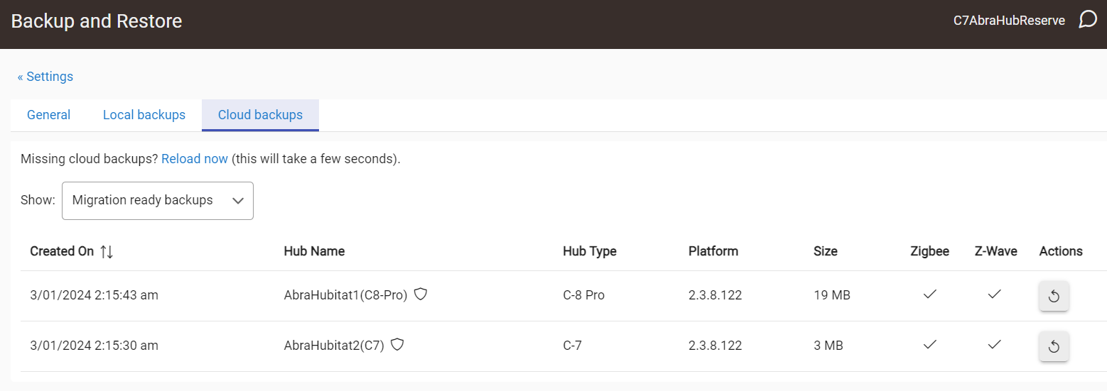

  4. Go to Settings>Backup and Restore and select the Cloud Backups tab
  5. If it isn't automatically chosen, select the Migration Ready Backups option in the Show dropdown to display your recent C8 backups availble for Migration (reminder - both your C8 and the Pro need to be registered to the same account):
  1. Choose the most recent complete backup and click the Action button to start the restore...make sure you select all the items you want to migrate:

The updated Z-Wave Z/IP Gateway is (partly?) what fixes the cloud backups. So possibly your hub did not update itself. You could try this endpoint to force it
HUB.IP/hub/advanced/installZipgateway718
It will spin and then say success or that you already have 7.18.3
Once you get success, wait a minute then run it again to very it worked. Once you get the "already installed" message then reboot the hub.
