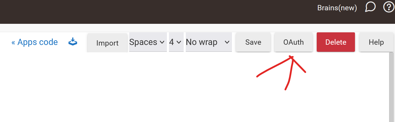

I've never installed Sharptools myself, but under APPS/DRIVERS code, is there an oauth button you can click and see if that helps?
Thanks - it looks like this option only exists for third party apps, not built-in apps?
Ahh, I forgot it's built in, my bad...

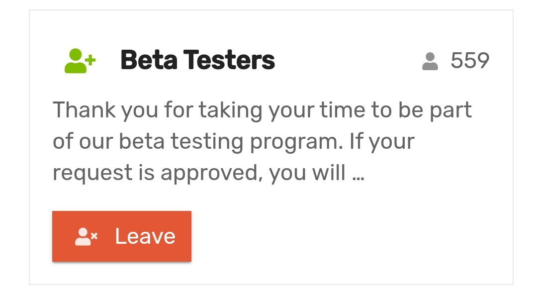

I'd still be incredibly interested to know just how many people are involved in the beta program, because I'm absolutely stunned at how widespread this latest problem appears to have been, and how hard this needed to be kicked before it received any public attention.
I'm happy this appears to be fine, but I remain deeply disappointed in the way the team have handled this. All it would have taken was a "yes, sorry about this, we are aware". Instead, nobody bothered to comment in public. Possibly because nobody wanted to publically acknowledge the issue. Which has caused me to lose a huge amount of confidence in the brand.
Unfortunately. And no offence intended, I've always taken a very, very positive view of the brand in general. This however has really left a sour taste for me.
Currently, 559. And that's just unique users, many have multiple hubs. We are always interested in increasing the number. Anyone who is interested in helping us, can join our beta group.
