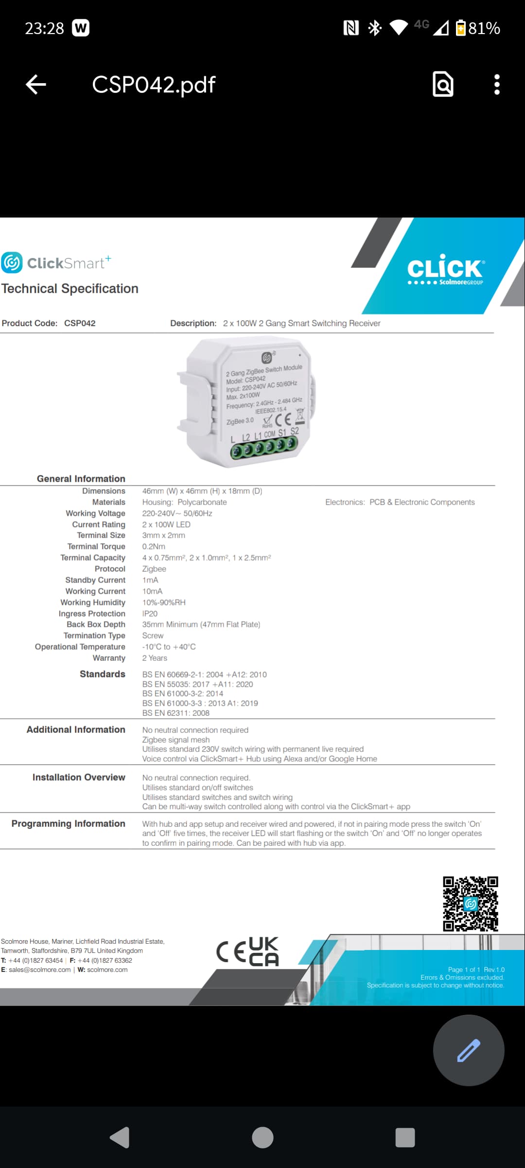

Hi, does anyone have any experience of the Click Smart relay modules. I have a few questions if you can help. Are L1 and L2 the supply inputs from the light switch. Subsequently will S1 and S2 be the outputs to the lighting load?
Also can these modules work from standard on/off light switche or are retractive switches required. I'm trying to understand that if the light switch is in the on position, then the light is turned off via the app, then will turning the light switch to the off position now turn the light back on. Basically does the conventional on/off position no longer exist. I.e. now a toggle of the switch now changes the light state to the opposite state.
Double-check the wiring diagram that should have come with this device, I think that it should be the opposite- S1/S2 typically are wired to the wall switches and L1/L2 output should go to the lights!
