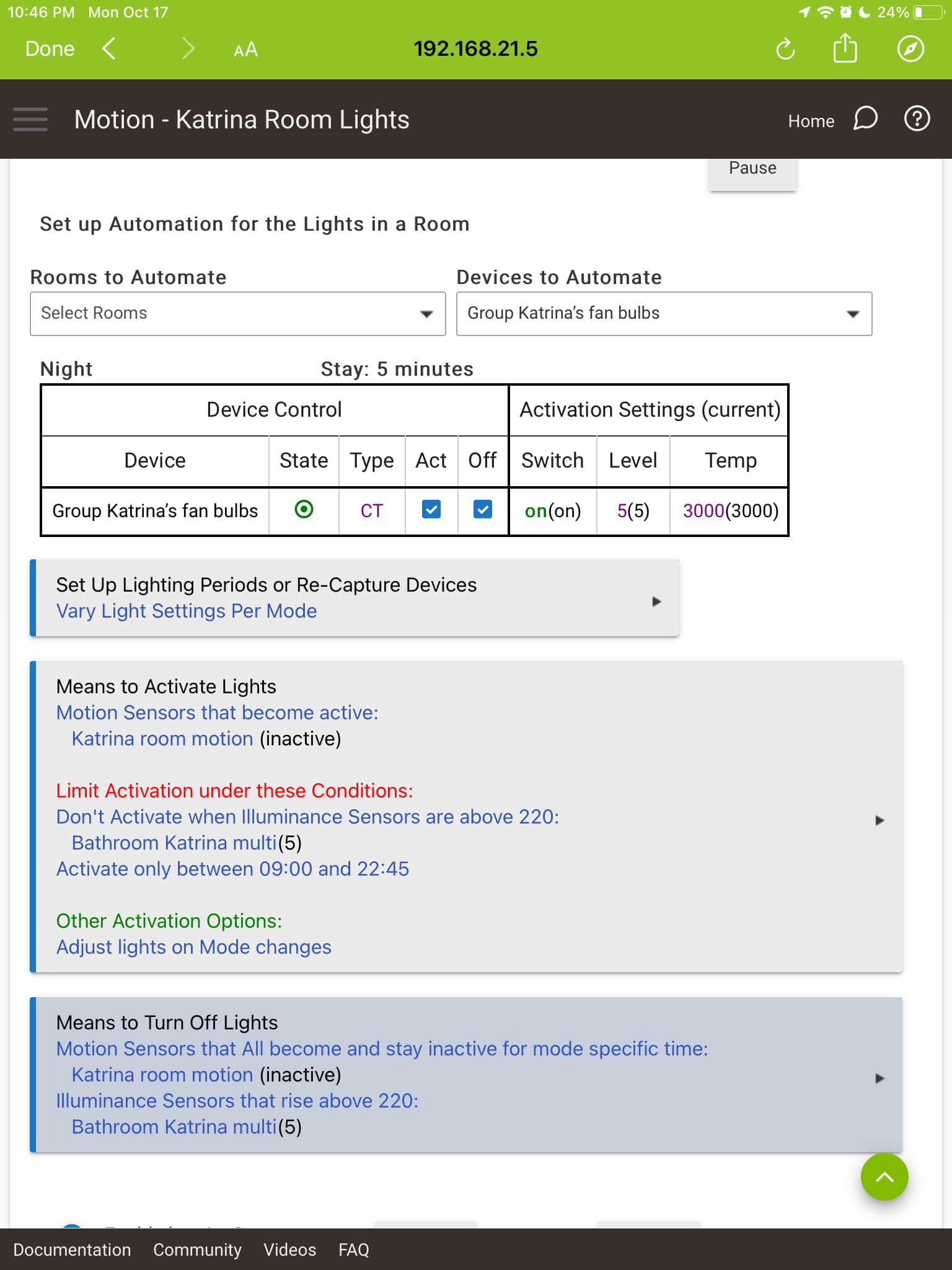

I have a room setup with 3 modes - day, evening and night covering all 24 hours triggered by motion but I only want the lights to only go on between 9am and 11pm. This part works flawlessly.
The lights are at full brightness during the day and evening but at night they are set to a dim level. I set the adjust for mode change which again works perfectly and dims the light when then mode changes to night and if the lights are on.
The lights may be manually turned off or turn off by inactive motion at night and this is where I have a problem. During the mode change to day which happens before 9am, the lights turn on to full. This makes sense the adjust for mode change setting but it overrides the time to turn on restriction from 9 to 10.
Shouldn't the adjust for mode change only apply when the lights are on? Or should the time restriction override the adjust for mode change so the app won't turn on lights if they are off?
Please show a screenshot of your main setup page for Room Lights.
