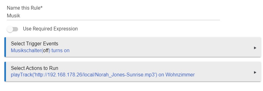

I don't know, if anyone else got this problem, but Chromecast just stopped working for me. I had a little rule, where I would use chromecast as my alarm, but for some reason, it never started. Re-Wrote it quick to test if the Nest Hub is the problem, but it doesn't work with the Nest Mini either.
Am I doing something wrong, or is anyone else experiencing the same problem?
I already tried to re-run discovery, as that worked before.
