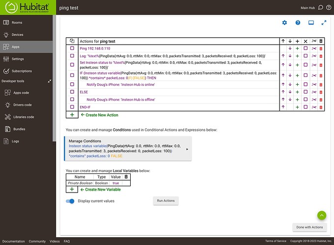

I am trying to check if LAN device (Hubduino) is powered on and on line by using RM Ping.
Rule has a local variable Ping_Status which I am trying to assign a returned %value%

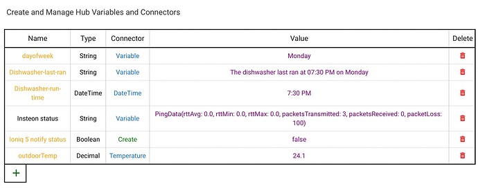

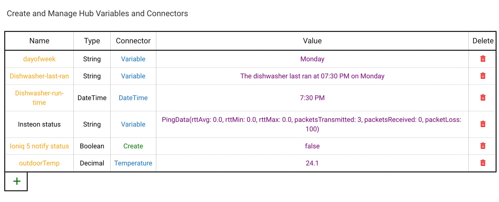

I always get a value of 0 when I ping, however for the reason of simply checking for a ping response, you can simply send the text result from the log for packet loss. A device online should have 0 or at least less than 100% packet loss and the log will indicate this.
I tested this and it successfully notifies me on my phone that my Insteon hub is online when I run the rule actions with it plugged in, and when I unplug my Insteon hub, it notifies me that it's offline when I run the rule actions.
To log the value, create a hub variable and the create a connector so you can retrieve it with a conditional action in your rule.

I am all set.
Set local variable to %value% absolutely must be right after the ping action.
If something is in between %value% becomes invalid.
