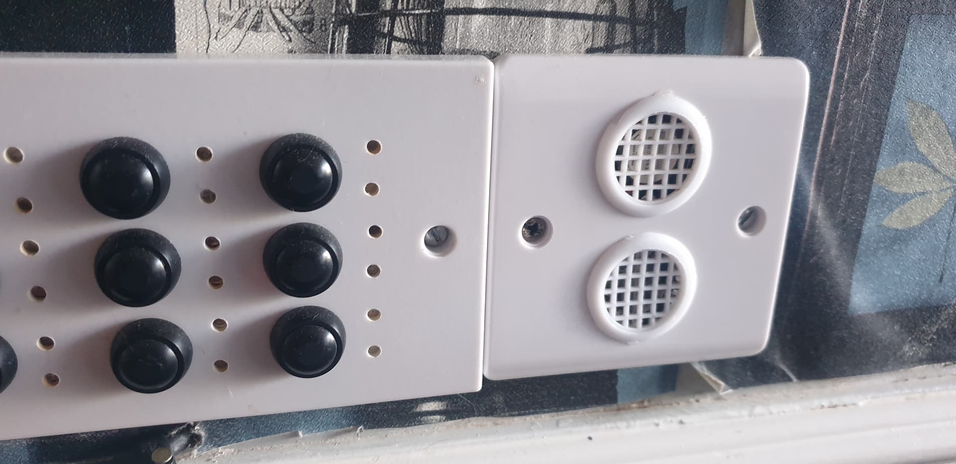

That's true. I mount mine inside a drywall box, with 5v fans to periodically draw air over the sensor. It's all very diy but looks great and works brilliantly.
Do you have a picture? Would be interesting to see.
Let's alter the "looks great" to "I think it looks great".
