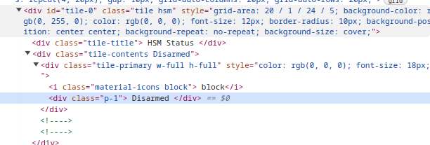

Open up your dashboard on your computer.
Right click on the HSM tile (preferably on the "Disarmed" word).
Click "Inspect" or "Inspect Element" (each browser is different).
This will open a console in your browser, probably on the bottom of the page.
Take a screenshot of that area.
It should look similar to the following:
Mine looks almost identical to yours, sans the tile number. I have CSS in to adjust the padding which works ok, it's just overriding the text.

But, for your exercise, here is the proper code to adjust the text via CSS:
div#tile-0 div.tile-contents div.tile-primary div.p-1:after { content: "TESTING"; }
