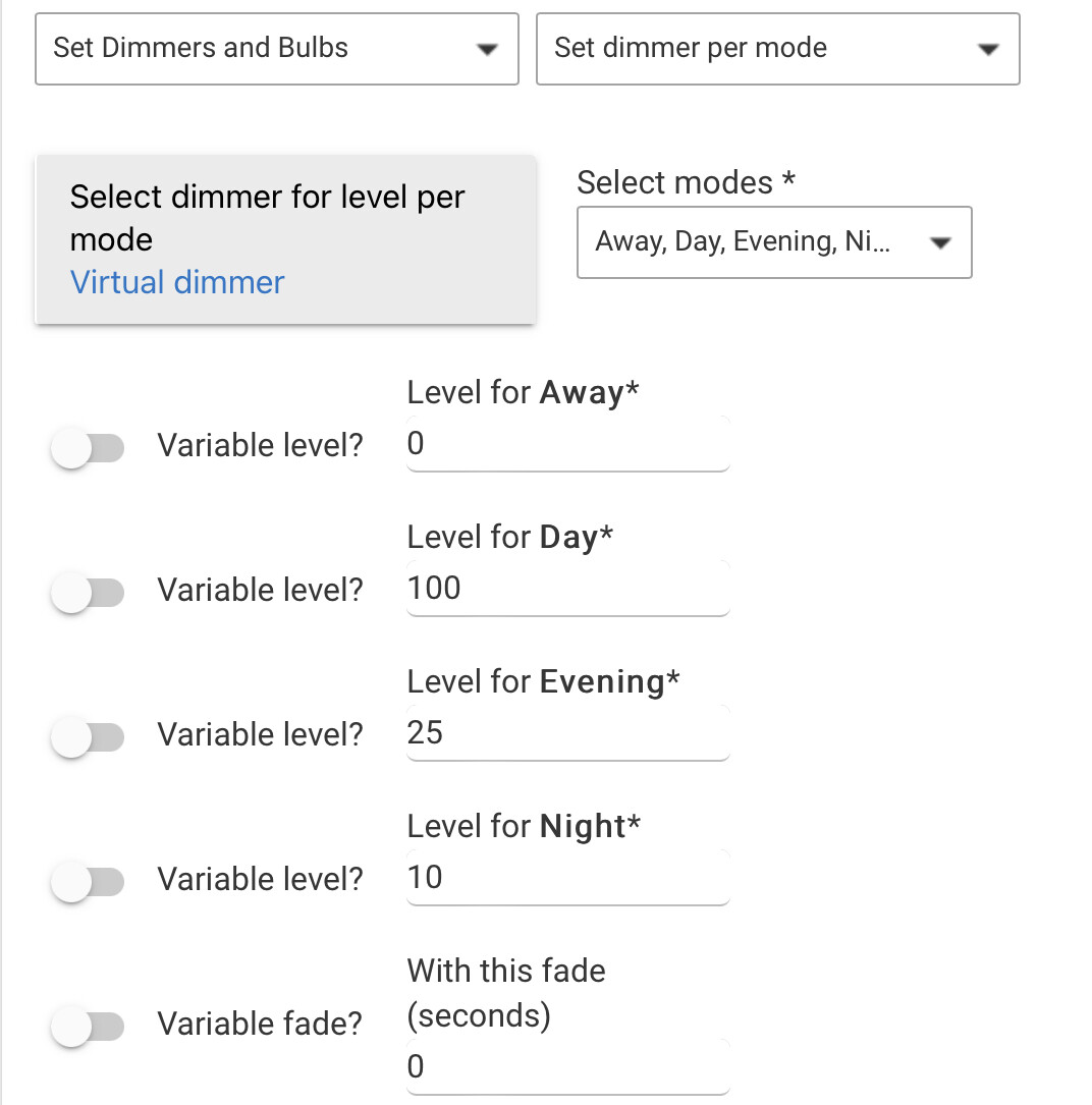

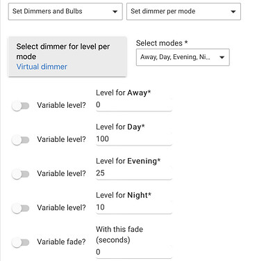

You could use Rule Machine to do this:
Either Motion Lighting or the new Room Lighting should be able to do what you want, however for the most part I don't think they can prestage levels. Prestaging really isn't necessary in my experience, the lights just turn on to the proper level once motion activates them.
I took some time today and figured out how to
Accomplish it with if then else in the rules machine. Being able to replace 2 basic rules (both of which had to execute each time) with a single rules machine entry has seemed to speed things up. After I was done doing that on all of my motion zones I had eliminated 16 basic rules and added 8 rules machine rules.
